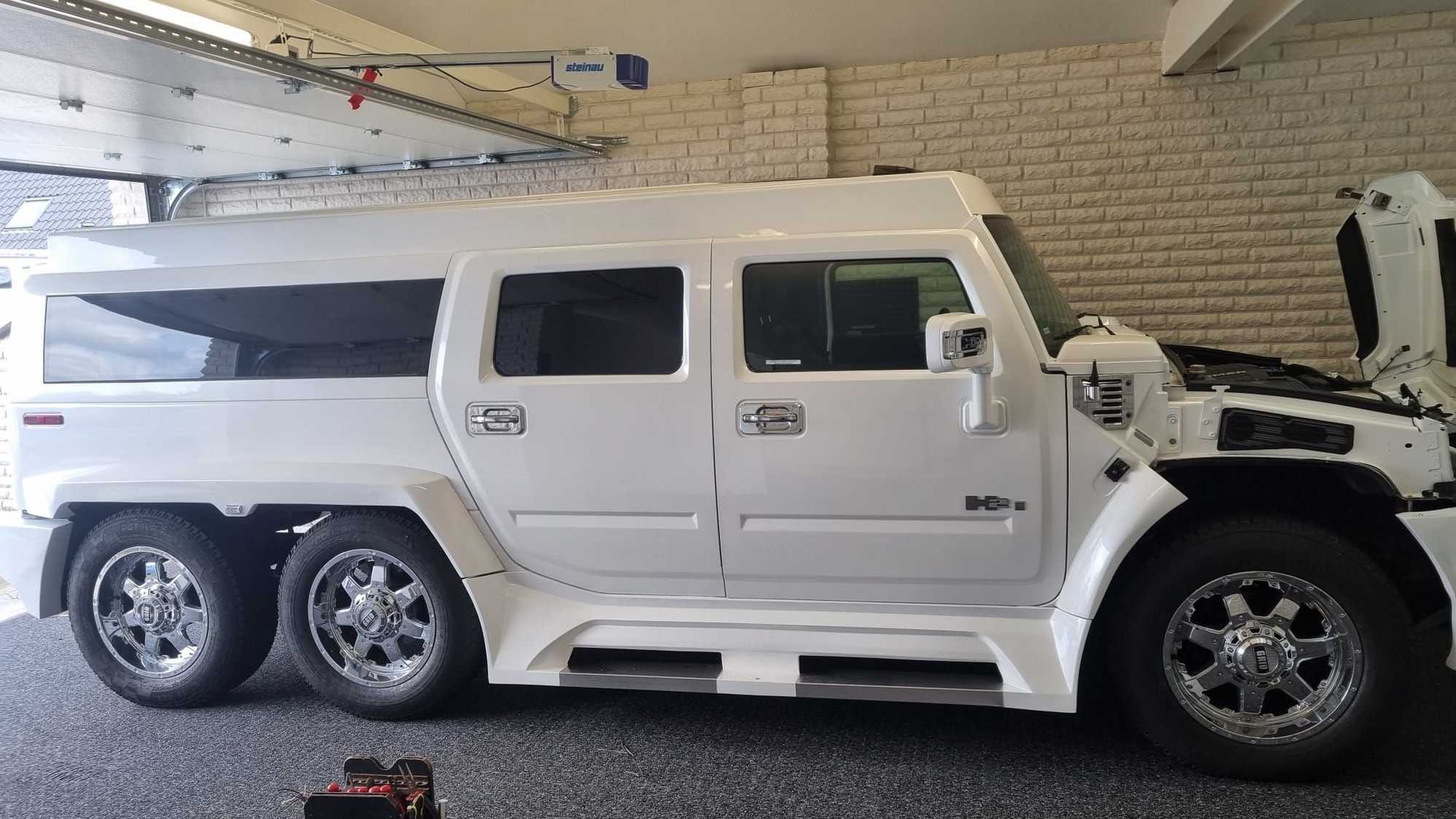

Greetings to all.
How can I release the shift lock without power on a 2008?
I don´t want to damage any plastic parts. Has it the same button like the 2003-2007 ?
Must I remove the console cover?
Have no shop manual
Many thanks
Volker
