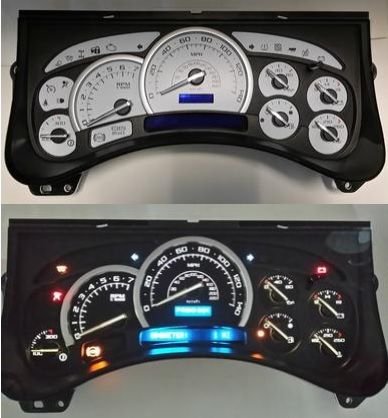

Old Jun 12, 2023 | 07:46 PM
  #27
Originally Posted by finall
Anyone else noticed that the 2008 H2 horsepower specs quoted here in the link are total BS?
Max horsepower is reached at 5700 RPM. Redline, LOL!
Try running your H2 at that RPM and see what happens……
GM bogus specs.
No Redline available. However, there are updated IPC's available with 7k rpm & 140mph. Yet, still no Redline:
