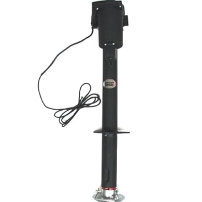

I bought a travel trailer to drag along behind my H2 and my only problem is the outside spare tire, which, as most know, hangs on the outside of the rear door. It gets in the way of the crank for the trailer....can't even hook up. I took the tire off and still the bracket is in the way. My option is, remove the outer hardware for my spare and throw the tire in the back...not my first choice...any suggestions? I can't use an extender because then you can only haul 65% of your towing capabilities. My trailer is 4300lbs not loaded, so the 65% would hurt me.
Thanks for any suggestions.

My first thought is electric tongue jack. $79 and problem solved.
Amazon.com: 3000 lbs Electric Power Tongue Jack RV Trailer Camper (PJ3000): Automotive

After talking to several hitch shops today, I'm inclined to agree with you. Thanks.
