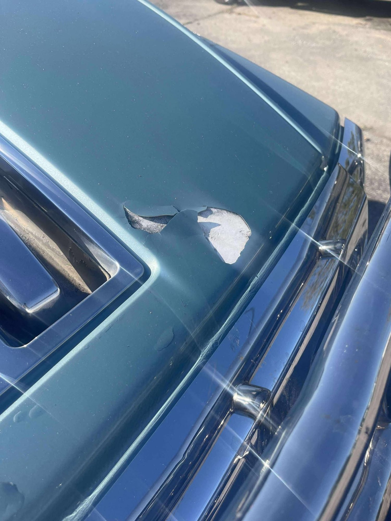

145,000 Mile H2 07 Glacier Blue, Paint peeling on hood. Is this normal? Never seen this before. $ to fix? Looking for a SUT, came across this one. Thx

Hell no. Either something hit the hood of that HUMMER to cause the paint to peel like that over time or a huge lack of washing and waxing the vehicle, or a combination of what I just said.
Old Oct 23, 2025 | 02:35 PM
looks to be a bad sealing job on a repaint. Possibly due to front end damge.
Look that frame and everything up front over very carefully.

Vehicle was in florida ga down south owner said maybe cause heat started peeling. I’m going to pass on this H2 Found another I like. Ty for responses gentlemen.

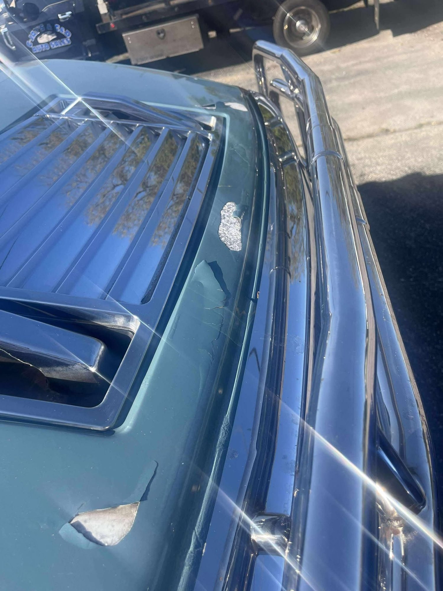

Heat doesn't just cause that. That's either a factory defect, or that hoods been poorly painted. Someone didn't prep or used the wrong primer. Id go with someone has painted it considering it looks like it hasn't started peeling until recently. Edit: You can actually see the bondo hack job in the top pic.

Looks like a low quality repaint. I've seen that over the years, usually 2 or 3 years after a Maaco economy paint job. Pressure washer or drive through car wash usually does this on those cheap paint jobs.
