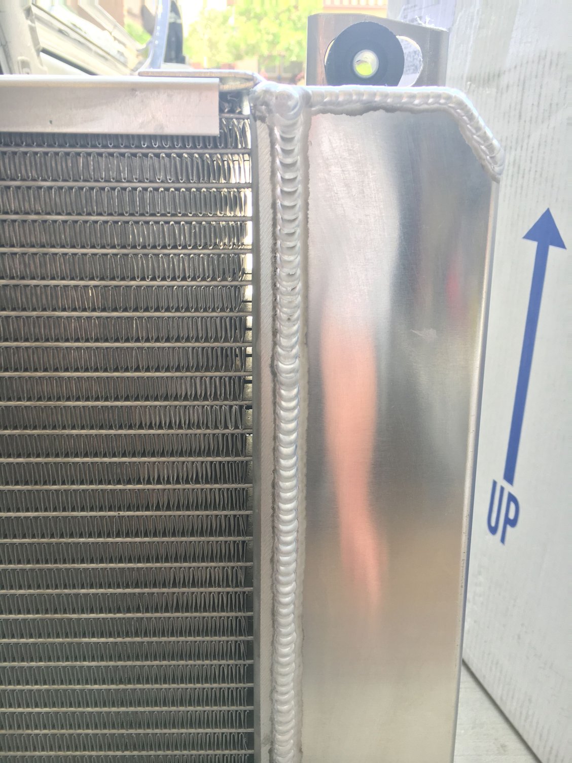

Boxed up nicely
Really nice welds all around
All the brackets look great and seem to be in the right location

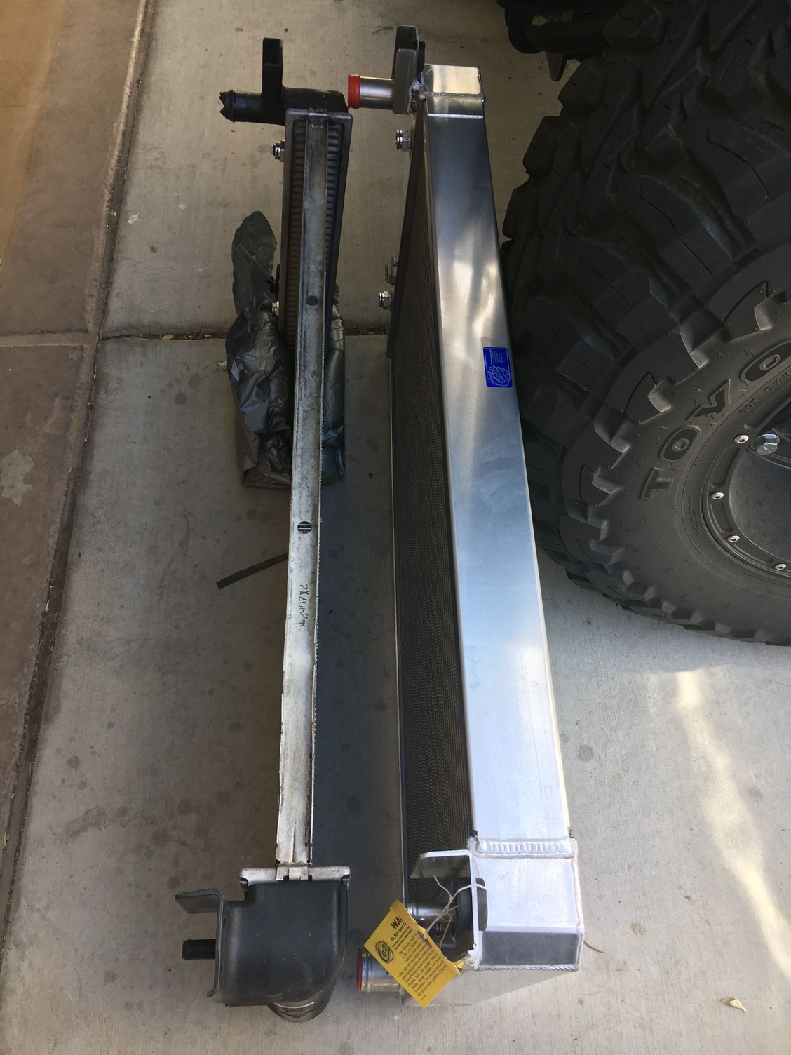

I can’t believe how much smaller the core is on the OEM radiator
FedEx just delivered my radiator new and old. I can’t believe the side by side difference. Build quality seems to be very nice and hopefully it will fit like it should. It’s really thick and I like it but I will breath easier once it’s in.
Looks huge installed
Really big radiator! It fits pretty good but the core is twice as thick and the tanks are square compared with the rounded oem. I am not touching anything but it took some massaging. The shroud doesn’t fit because the core is wider and it went inside the oem radiator and it really needs to sit on top of the new radiator and that makes the fan contact the bottom of the shroud. I cut the upper flange to allow it to sit lower but it will need to be spaced 3/8” away from the mounting surface but will be against the radiator. I’m going to do a little research on electric fans because then it wouldn’t matter if it 1/2” higher or lower. The transmission cooler lines fit really good and everything lined up really good.
