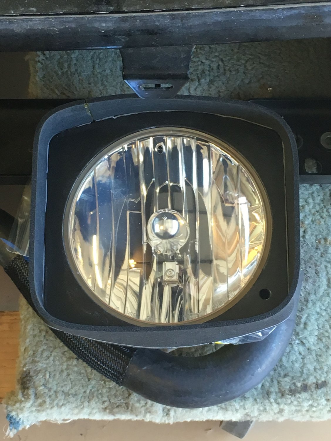

I think I’m getting the hang of the headlight rubber replace. I need 1/8” wetsuit material with the smooth side towards the light. I placed in the grill as best as I could with both floating and I think it’s gonna work. Used double sided tape and put the led’s for my steps back in. Tomorrow I get cooler fittings so I should be able to make up the lines and just have a cut to separate them and I should receive an update on my radiator that should be done by now

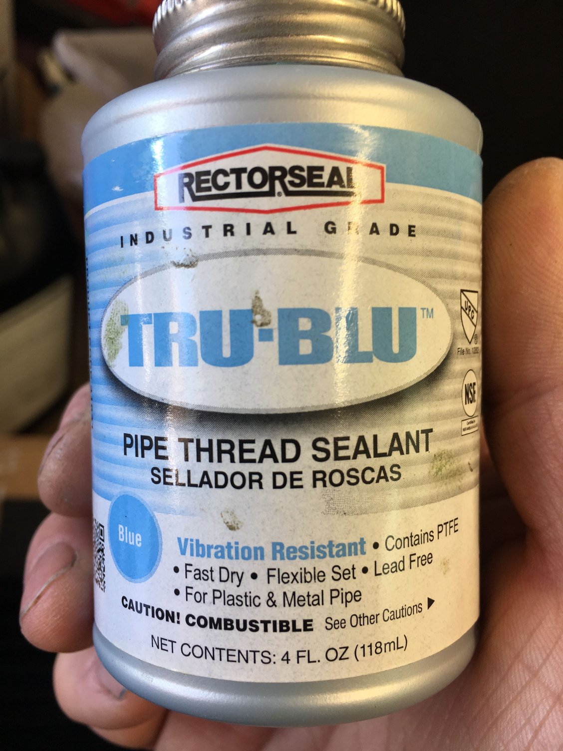

I used tru blue on the adapter that goes into the cooler. Shouldn’t be necessary but from 2 different manufacturers. I used a dab of grease on the tip to help it seat and it threaded in really smooth.
525 Fitters swear by this stuff...
Called Be Cool to check on my radiator and Fred said that they are still waiting on my 34” core. I can’t believe it’s that big of deal and I think it’s been 2 weeks since they received my radiator for a pattern. UPS delivered my fittings and I started to install the lines.
