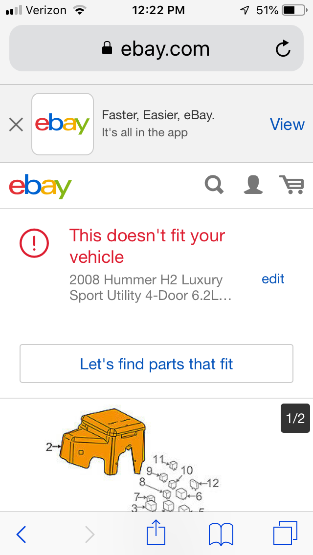

Did I do something wrong?Mixman I just went to order it and this is what I got? I just sent seller a question and included your picture! I really want mine like that

Wait - if your IS a 2008 than I'm not sure....
I can say this - if yours is identical other than not having the extra cover on the corner than yes it will fit. I'm not sure if the new generation 08/09 models have a different fusebox though. This cover fits 1999-2007 GM trucks and full size SUV's including the H2 for sure.
As far as eBay's vehicle parts matching system. Yours did not come with the fans from the factory so that is technically the wrong cover for it. I've also seen other actual errors in their system as well.
Mine is a 2007 but I entered 2008 for check fit because I thought that’s what is on the 2008 with the electric fans?
Old Jul 14, 2019 | 02:52 PM
  #165
You are good then.... Order it. I just looked and this will not fit a 2008 at all. Different electrical system and fuse box. While the 08/09 came with electric fans, they are setup different than ours. You need to do things for a 03-07 GM truck in this respect. The factory style harness for the fans with the relays that fit under that cover that I also linked are the type you woudl need for yours as well.

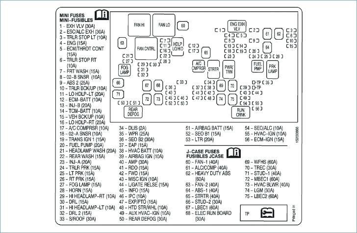

I found this for a 2008 Denali and it’s way different and part of the main box.
