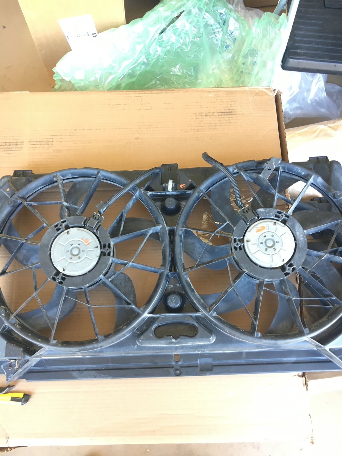

Just got my second fan assembly and it’s still a 5 blade 7 blade assembly and the tap that goes to the side of the radiator was hanging out of the box and broken off and the upper mounting was also broken. This LKQ is 15 miles from my home and I can’t believe all this happened to it because of UPS! Nobody does anything right anymore! I think I’m going to have a whole pile of these before they get me the right one! Hahaha
Old Jul 20, 2019 | 06:43 PM
  #210
Oh wow! I would double check the compatibility now that I think of it. I think I also saw on the newer generation that the fans are PWM speed controlled. I could very well be wrong though. That makes me wonder if they might be different electrically is my worry. I might double check or ask on some of the GM truck forums. I'd hate for you to get something in for a newer model and they either not fit or not work electrically.
I did not get factory fans either for mine. I they were an aftermarket brand but with great reviews and a perfect factory fit. I think it was TYC and they were about $150.
I'll double check in the morning what ones I got as well as look in the GM eSI system and see if it gives me any clues on how they work on a newer model.
