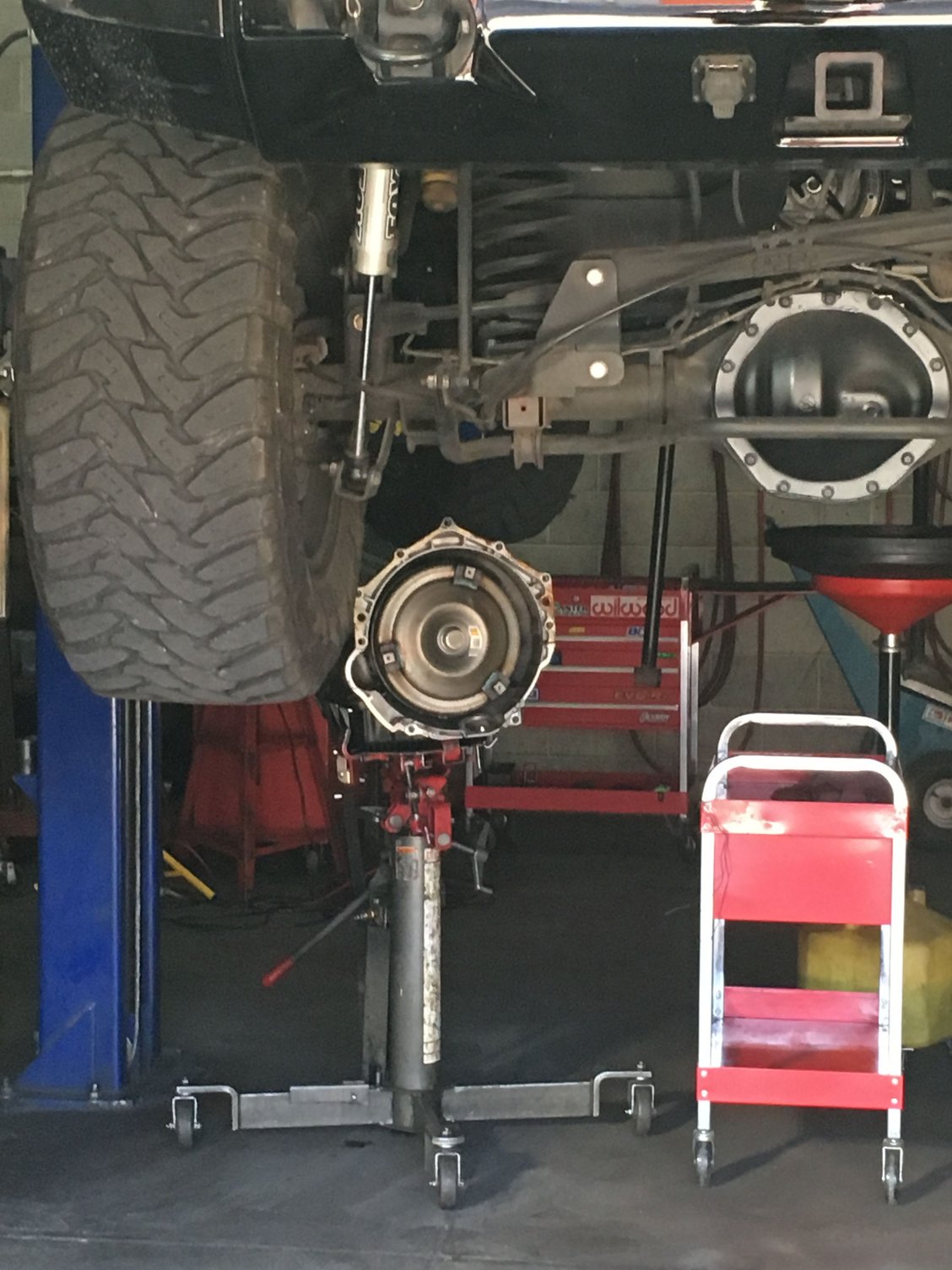

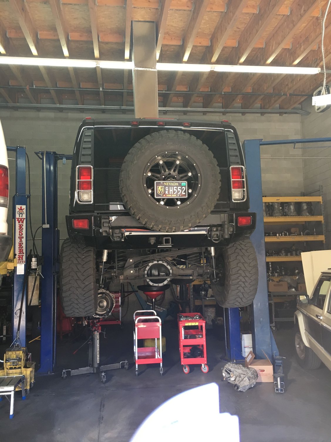

This is really hard on me because I don’t like anyone working on my stuff! I bet OP feel the same way here
I just called BP Automotive and ordered my fan harness and it was 150 + 10 shipping. Funny thing I went to purchase it last night on there site and shipping was 16.66 and when I called to order it she said they only charge 10 flat shipping rate. Saved 6 bucks by making a phone call and I asked again if this will work on my H2. I believe I have everything I need except for tuning. Took instructions for the Sonnax stuff I bought to Bobs Transmission shop today and the transmission was out and looking good. Maybe tomorrow or Thursday it should be done.
