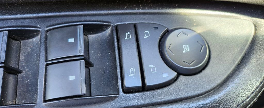

The 2009 mirror controls are different. There is a switch which rocks to the left and turns on an LED in the button switch. That indicates that the Mirror up down left right is now selected for the left then below is a seperate switch that is the button that controls the direction you want the mirror to go. There is also a seperate switch that folds Both Mirrors at once. It is function Open or Closed depending on which direction you move that switch.
The Video you posted has those functions in the one button . By pressing down you select the fold mode if I remember correctly. But I will try the reset thing using the instructions. I have moved the passenger side manually ..so maybe this will help. Thanks for the research.

Here is a Pic of the 2009 H2 Mirror Controls. Notice the small square in the switch which is the indication for "ON" on the side you select on the control switch.
