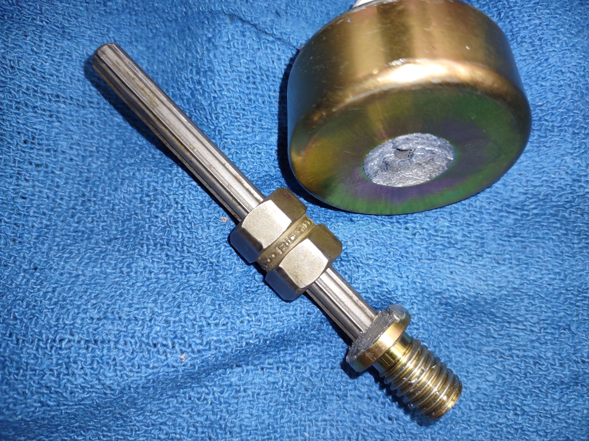

Occasional fluctuation in oil pressure. Went back in to replace the NAPA oil pressure sending unit with an ACDelco. Figured I'd go ahead and replace the Napa knock sensors while I was in there. Of course one of them snapped off. Snap on to the rescue, pun intended LOL, my 25-year-old screw extractor easily took it out.
I taped everything around it with plastic like a surgeon around a surgical site, followed by the Shop-Vac and a strong magnet. Then rinse and repeat with brake cleaner. Since I was being so thorough I figured I might as well change the oil and filter, at which point I discovered a little coolant in the bottom of the oil pan. About 110,000 mi so I splurged on a set of new heads and replace the head gaskets. Dropped in LS7 lifters. Figured this would be a good time to install a standalone oil cooler for the engine and a tranny cooler also bypassing the radiator. Being thorough and being on a roll, went ahead and dropped the front differential and the oil pan, pulled off the harmonic balancer, water pump and front cover to do a new timing chain set. And inspection of the oil pump I discovered the pressure relief valve sticking. Actually had three little tiny pieces of some sort of grit like carbon near the bottom. New oil pump arriving tomorrow, Melling 295. The 7.35 pushrods are also arriving tomorrow. Pulled the camshaft while I was in there and the front bearing actually looks really good. Almost pulled the motor to replace the bearings and rings till I saw that. Original hone marks still on the cylinders.
