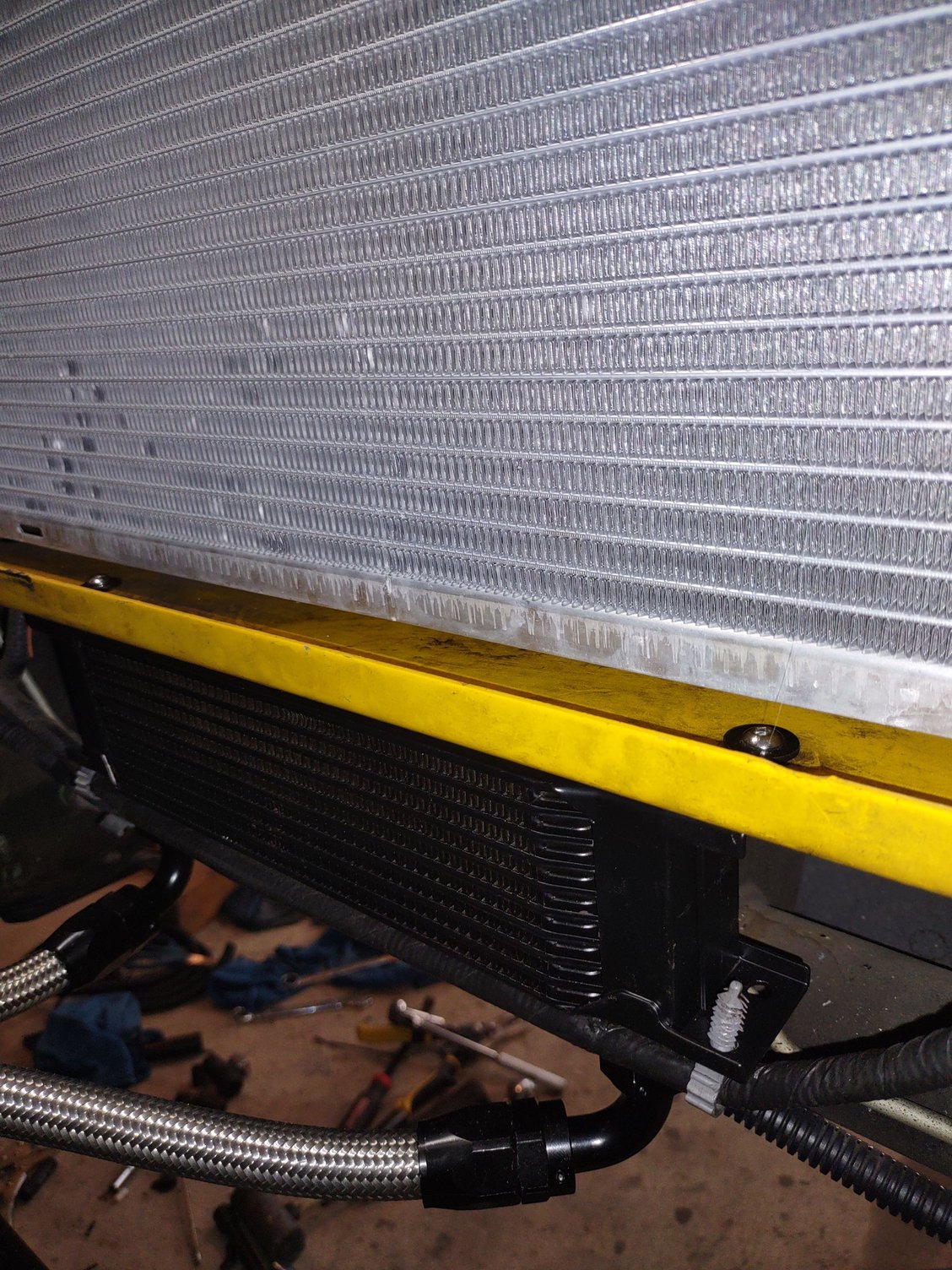

Well, the list of while I'm in there grew quite a bit as usual. Besides the new oil pump, timing chain set, two new cylinder heads.... Unquestionably the oil pump check valve was sticking so that solved the fluctuating oil pressure. But I could not definitely determine the head gasket was responsible for a little bit of coolant in the oil and oil in the coolant. So I threw in a brand new radiator, added and external oil cooler to rule out any future issues. Also added an auxiliary transmission cooler to run in series with the factory one, bypassing the radiator. All that's left is to throw the intake on!

10an on the oil cooler lines. I went with 6an on the external transmission cooler. Nothing special on the engine, just a stock lq4. The red valve covers I've had for about 6 months and have been quite pleased with them. It's an upgrade to the newer style found on the 6.2 that has the better PVC baffle built in, eliminating for the most part oil building up in the intake. Very reasonable on Amazon:

Default Better picture of oil cooler

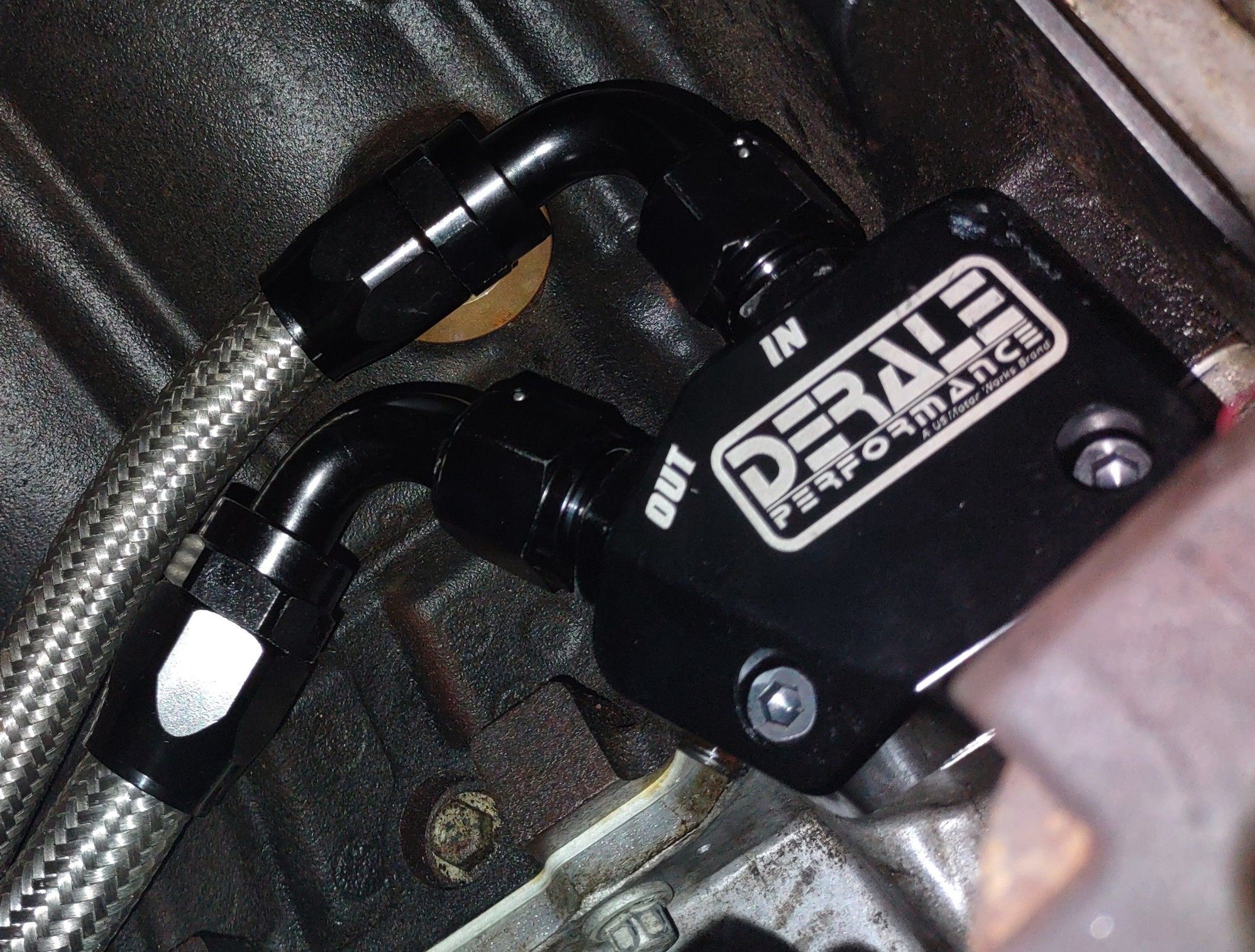

Default Also bypass the radiator for the transmission cooling
Also didn't want to take a chance with a failure on the transmission cooler side of the radiator. So while replacing the radiator I bypassed first to a new OEM tranny cooler, the next in line was an aftermarket Derale tube and fin cooler which I went with strictly because of limited space. On my test run detailed above, transmission settled at 155° at freeway speed of 60 mph.

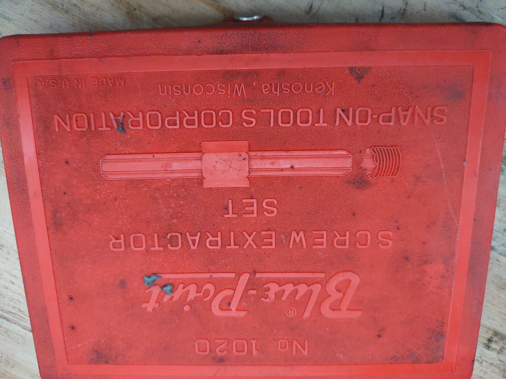

Looks like a Ridgid bolt extractor, not the coveted Snap-On?

I've had this set since probably the mid 1980's when I worked on aircraft. Never even noticed that all of the collars say Rigid around the middle. Wonder if snap-on was involved in rebranding?
