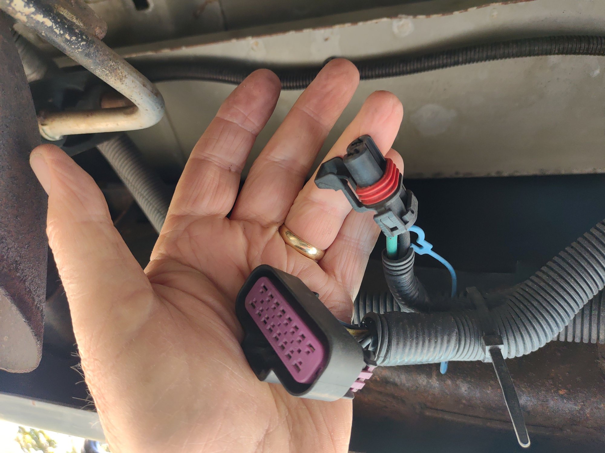

It would be worth checking to see if it's 16-Way connector is in the harness, it's located around the Right Rear suspension.
Fuse or no fuse makes no difference, corrosion around the data lines can short communications.

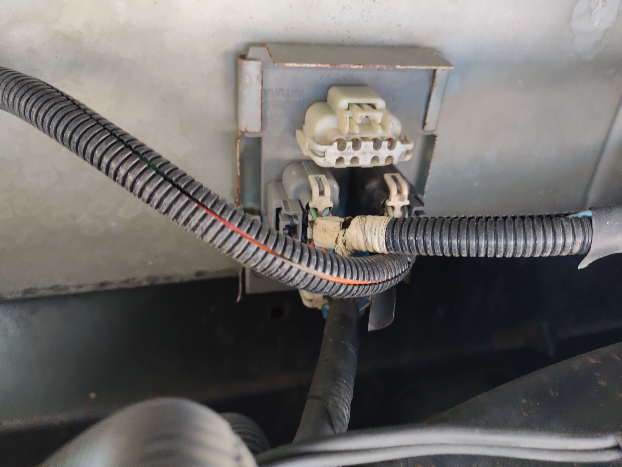

Per Oceans suggestion the 2 connectors that would have been connected to the air suspension look like this and will be hanging near the center to right side under the rear bumper area.
