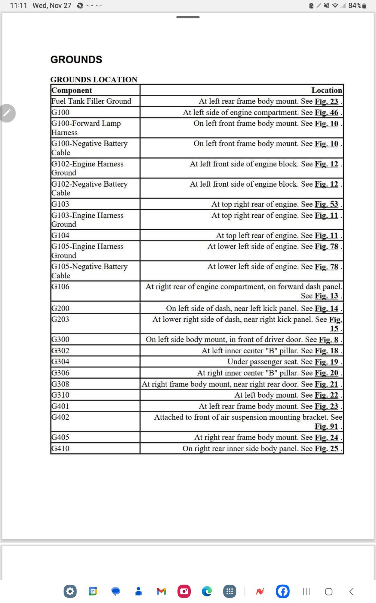

From: Port St Lucie, Florida
Metal -- understand better with above info and previous rain water issues. As Bronx stated, starting to sound like potential ground(s) issue and it does occur at the left and right kick panel locations due to water intrusion at those locations just as you indicated. I have a grounds file with figures but it is 1.2MB so not sure how to get it to you. Also check all the connectors at the IP power block just to the left of the brake pedal for corrosion.

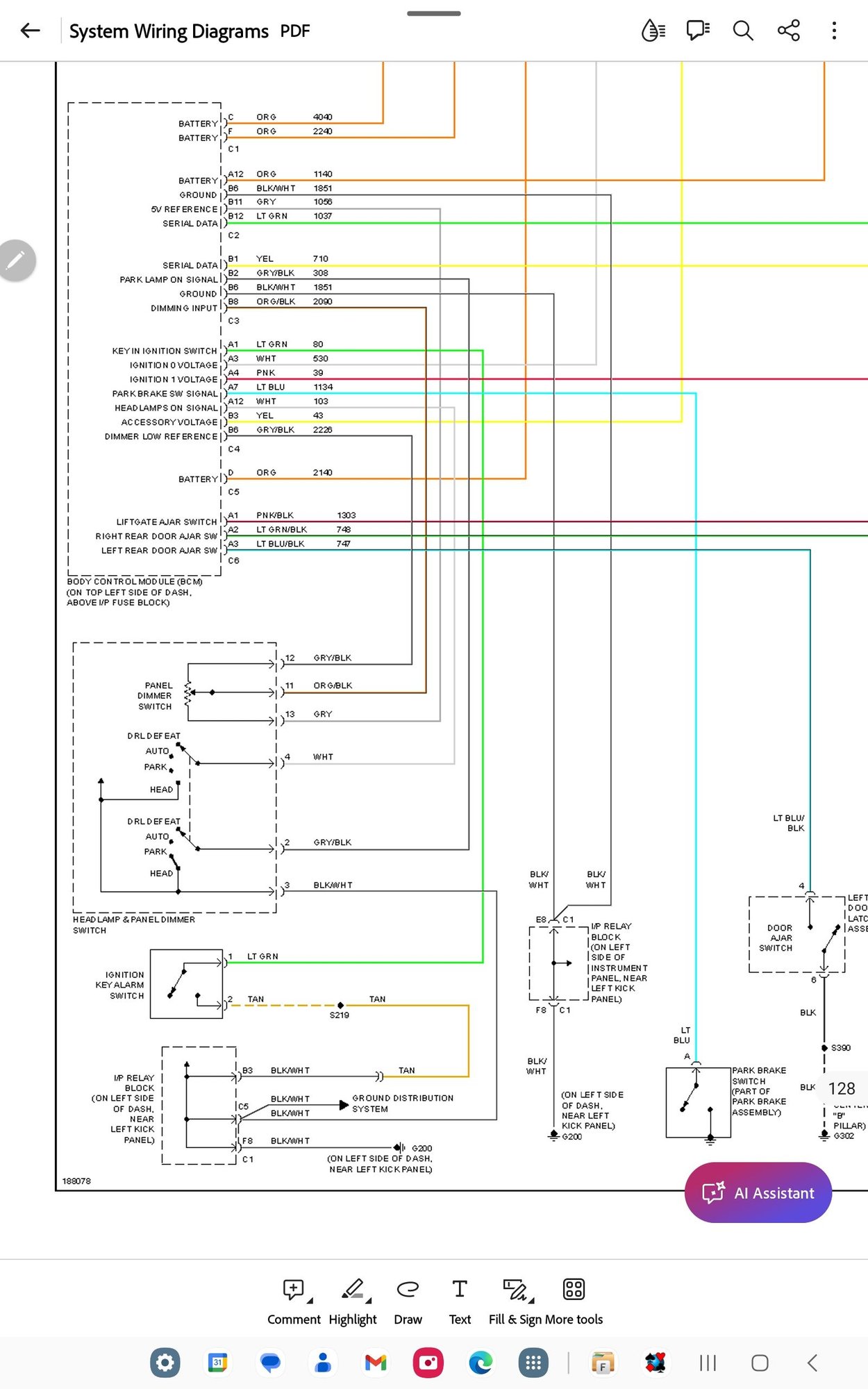

PGI Conch's Avatar
Joined: Aug 2021
Posts: 210
Metal - note in following that at least 2 of the BCM grounds go thru the IP relay block before getting to the ground location on the kick panel Bronx and I mentioned above.
Old Nov 27, 2024 | 11:10 AM
FFMetal's Avatar
Joined: Nov 2023
Posts: 15
Thats great thank you guys! I found the files in the forum and downed them to my pc. I didn't realize how many grounds there are and the water went right down in those kick panels too. I'll take a dremel to them then dielectric grease all of them.
