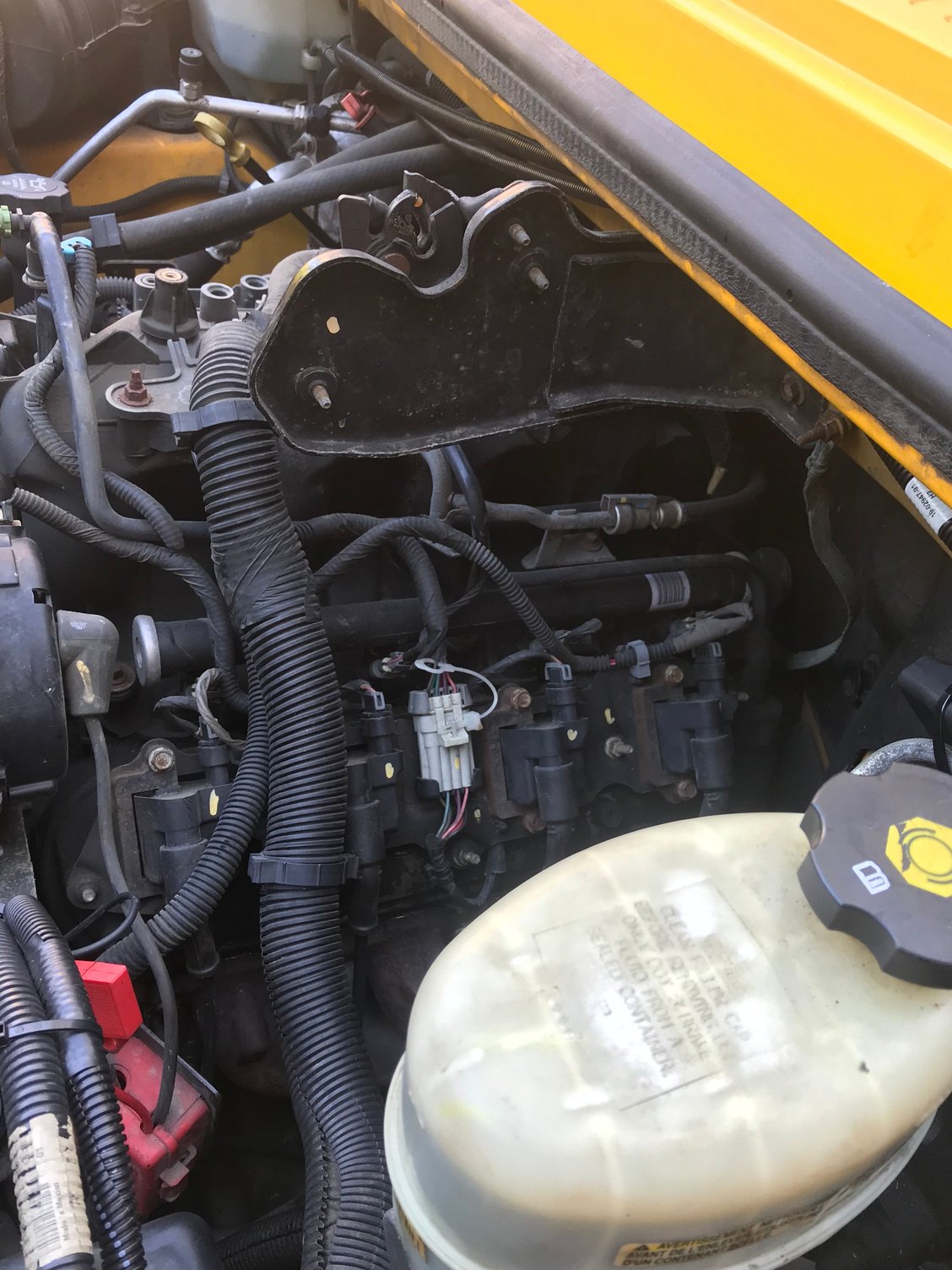

Can someone help me identify where the FPR is? I am not able to find it.

in the tank with the pump, you mentioned you have a new pump right?
Right I thought this was true. Yes, new pump and all new sensors too.
