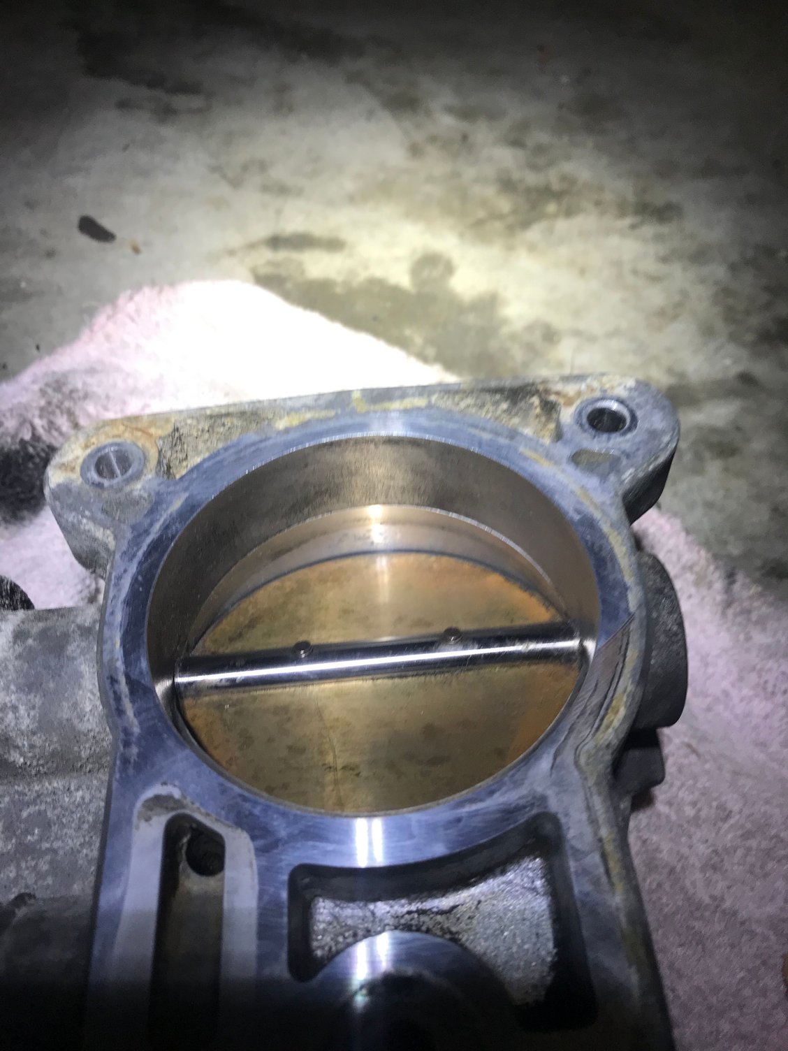

When I start my H2 and let it idle it will have an erratic idle (needle bobs up and down a bit). It drives great... but when I stop at a light it has an erratic idle again. I thought I’d work on it a bit today. So I picked up some mass air flow sensor cleaner and some throttle body cleaner... some plugs, and new wires. Cleaned and replaced and nothing changed. I had an old car once that did something similar due to dirty IAC (idle air control valve)... but I don’t see one on the Hummer???

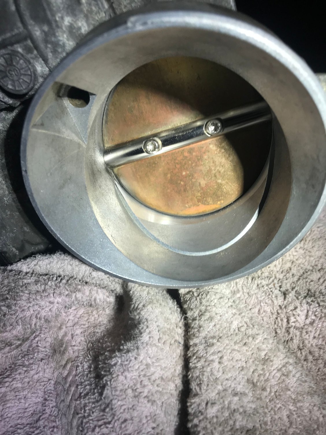

I pulled the TB all the way off and cleaned the heck out of it. It’s spotless for what it is. So I’m ruling that out.
