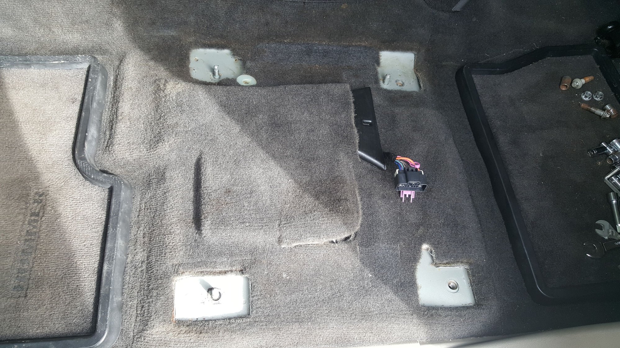

This was actually a fairly easy job. I disconnected my battery just in case because I wasn't sure if it would cause any airbag problems. I removed the rear bolts first, then moved the seat back, then disconnected the battery and waited 30 minutes, then unbolted the front. I confirmed that you can indeed use regular sockets instead of buying torx and they will unbolt no problem. There is 1 plug from the seat bottom to the chassis, and I also had to unplug my headrest dvd player, then the seat just comes right out.

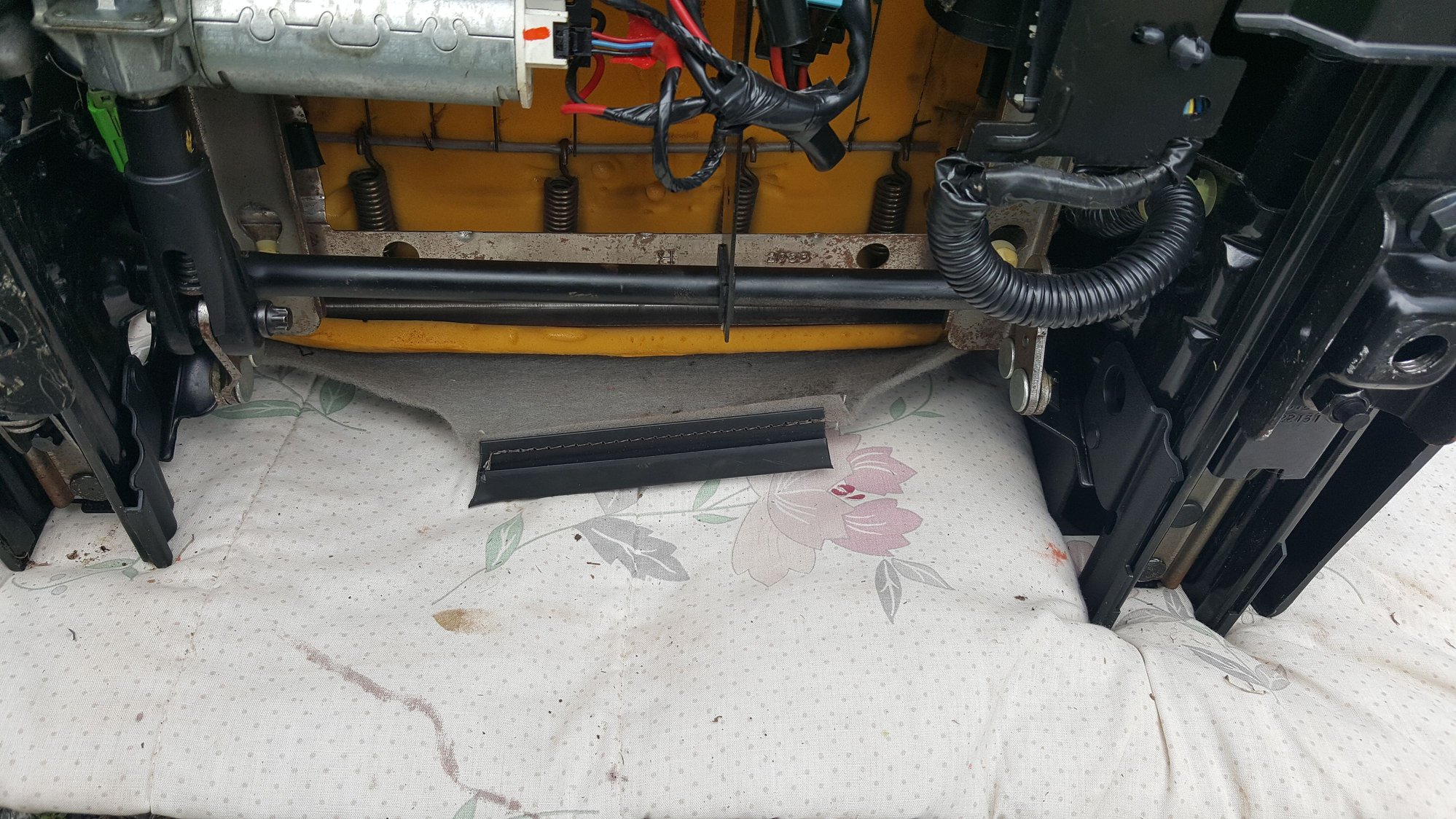

I actually learned how to fix the factory seat heat. It's an easy fix and far better than the after-market replacements
0) Remove the lower cushion and peel back the rear part of the seat cover
1) carefully cut the foam right up against the seam adjoining the carpet
2) Melt away the the left and right side where you'll see a crimp that connects the wire to the carbon fiber heating lines. This is where the circuits break and the elements fail
3) Re-solder the wire to the crimp and test with an Ohm meter. It should ramp up to about 4.2 ohms after the repair
4) Plug-in and test
5) Glue back down the crimp and wire with a hot glue gun, and squeeze the two foam layers together
6) Re-seam where you made the cut with 3M Super Adhesive 77
7) Re-install the lower seat cushion
I have now repaired two seats in the exact same location of two 2006 H2s. On both, the right side wire (seat switch side) on the passenger seat were breaking just below the crimp. These seats had a lot less use and failed well before the driver seat which tells me that there was a run of passenger cushions that the wires were not properly seated with hot glue causing them to prematurely fail. The VIN range between my two 2006s are 102013 to 107851.

Yes, I unbolted the seat completely and tilted it back to rest on the back seat while I removed the lower cushion. It's easy to work on and test if it's still in the truck.
