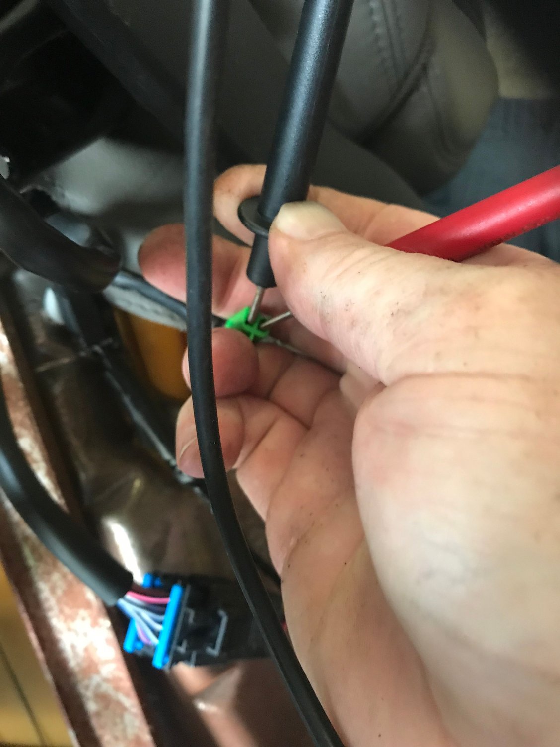

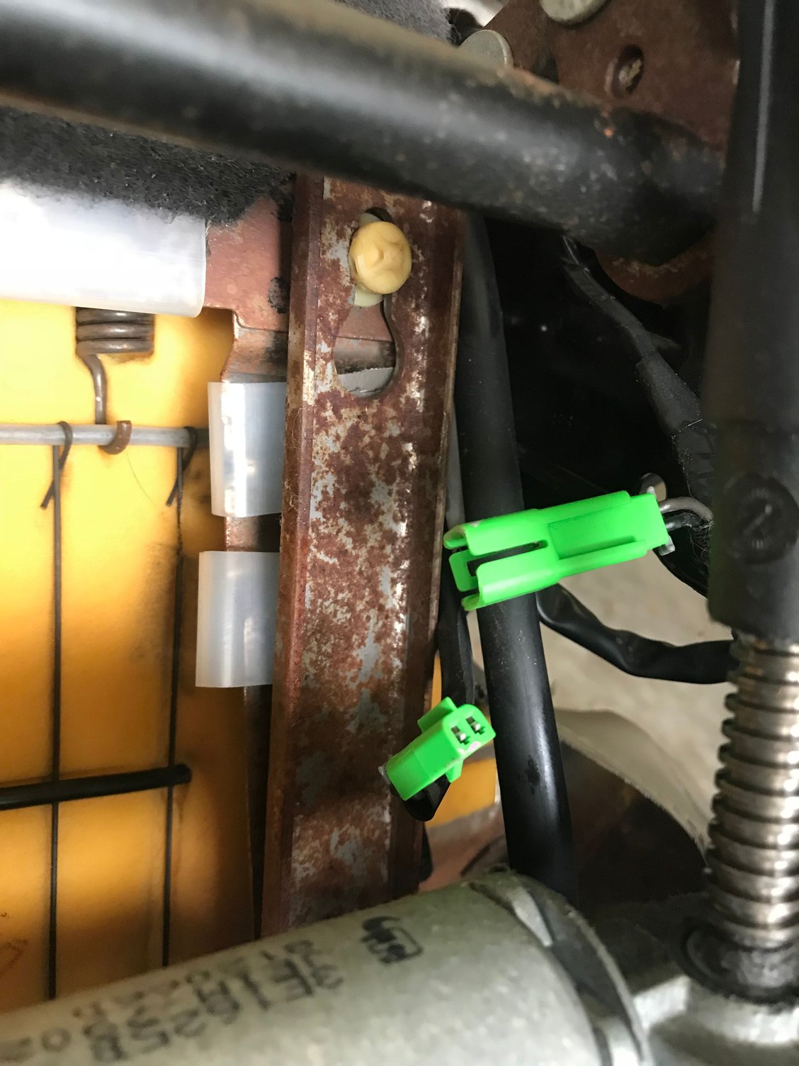

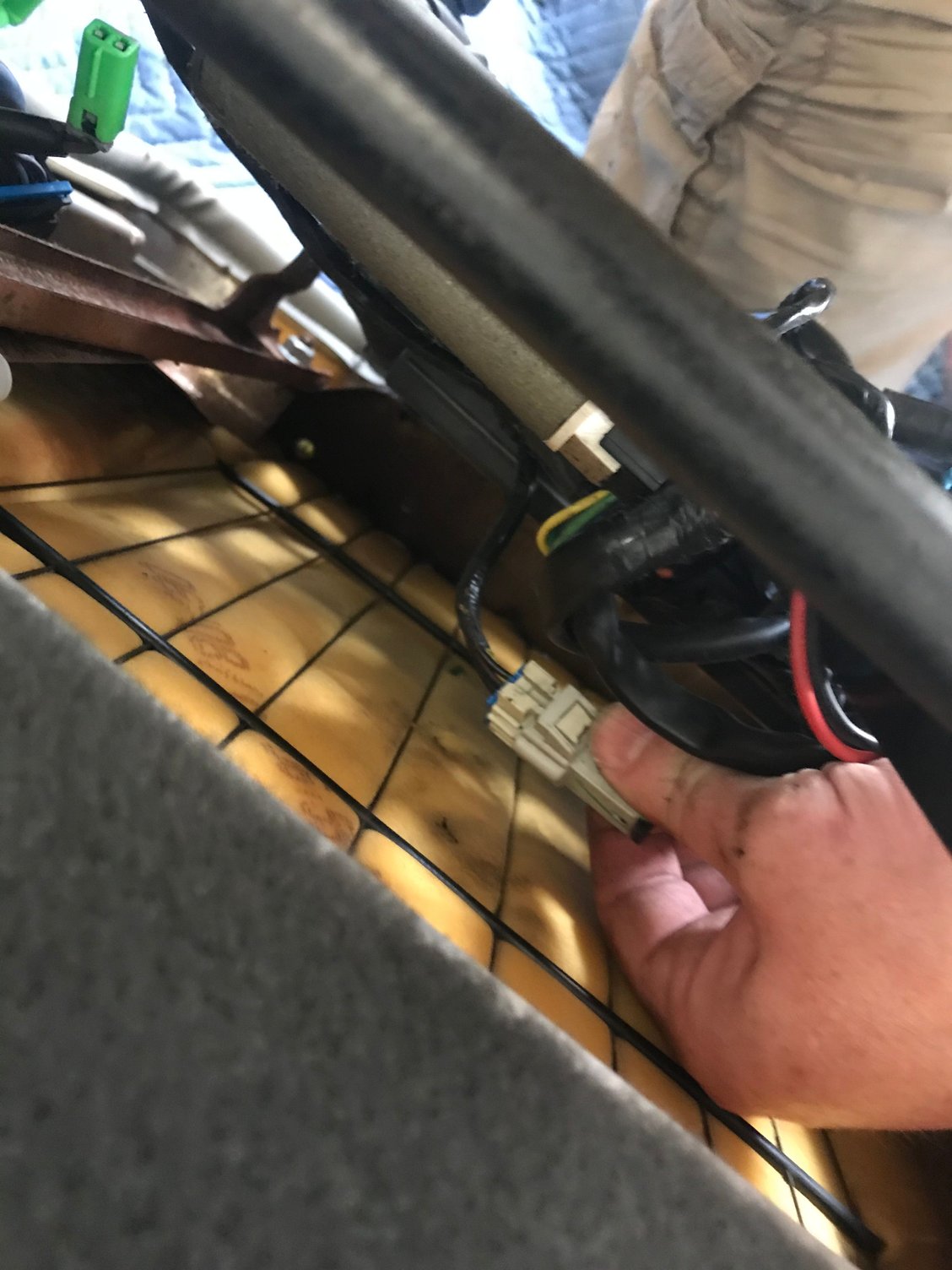

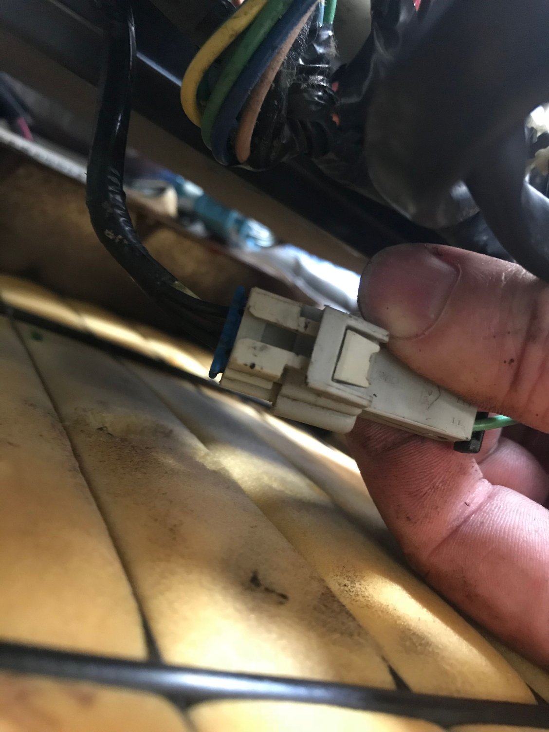

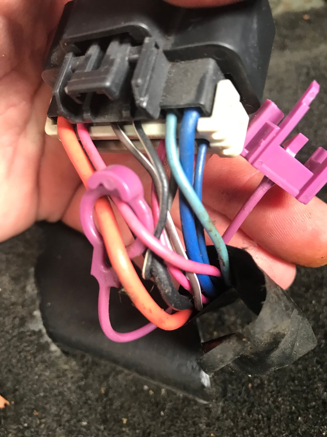

Well seat is out, no burnt wires, plugs all look good. So it would appear I have a faulty switch and I couldn’t tell when I had it apart. Or one of the heating elements could be fried. I measured the ohms on one side and it was 4.6 (no idea if that means anything) I got side tracked and haven’t fooled with the other side.
I wish i had had learned something. The seat is really heavy... if had two back surgeries so I’m not a fan of awkward lifting these days.
Please share if if anyone has ideas... I’m fresh out. I wish I could borrow someone’s switch... takes like 15 min to pull it. But I don’t know anyone.
Plug on the floor side
Pin out for the plug on the floor side
Seat slider and harness
This is the plug going to the heating elements
I think this is where the heating elements get power
Side view of possible power supply for the heating element.
Measurement of the heating element (female side not sure if that is top or bottom)
Plug measured
