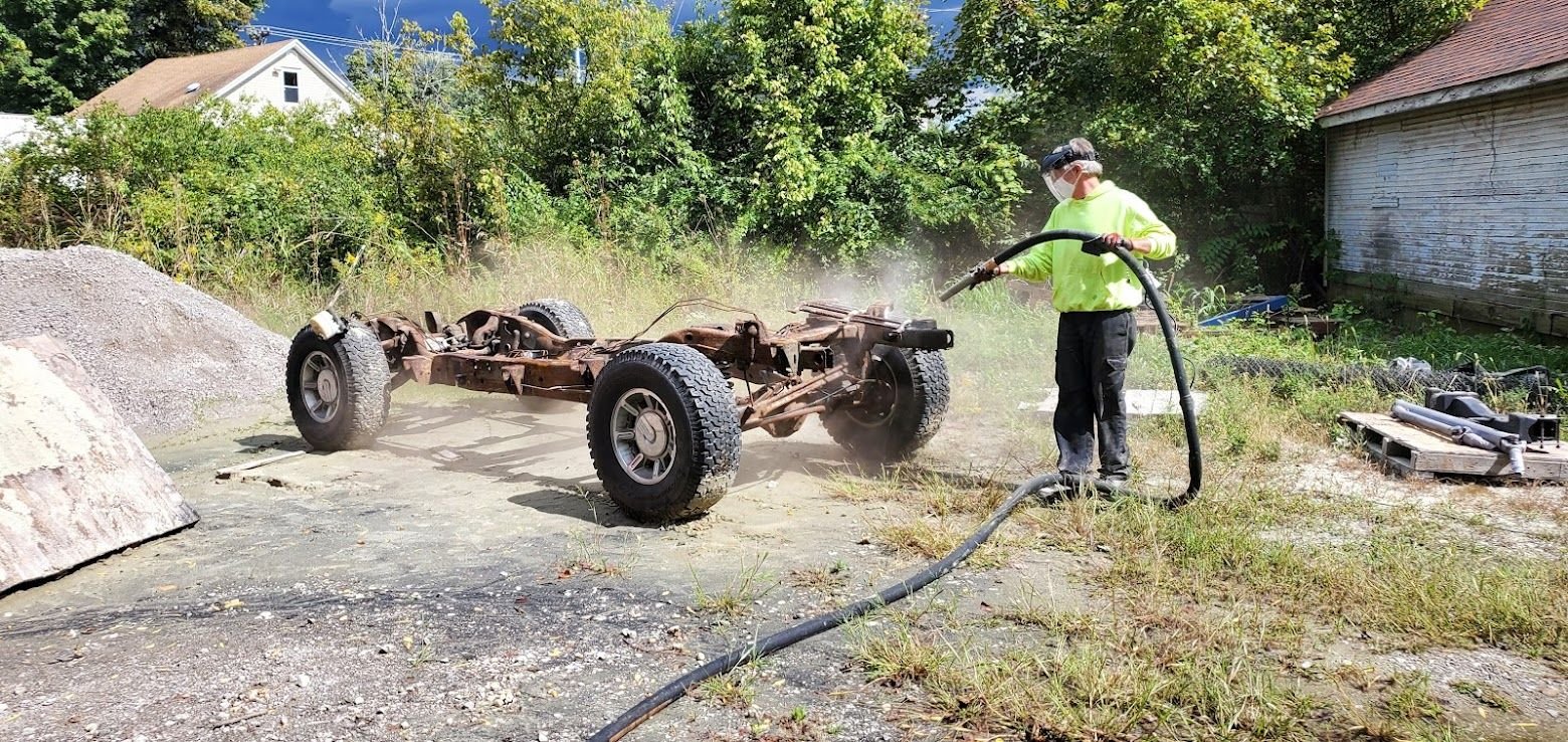

Yes, PCM/ECM same thing. We did do a lot of work. Sand blasted and painted the frame. Replaced brake lines and hoses, fuel lines, fuel pump, body mounts, exhaust manifolds, among other things.

Just saw your pics, very impressive
