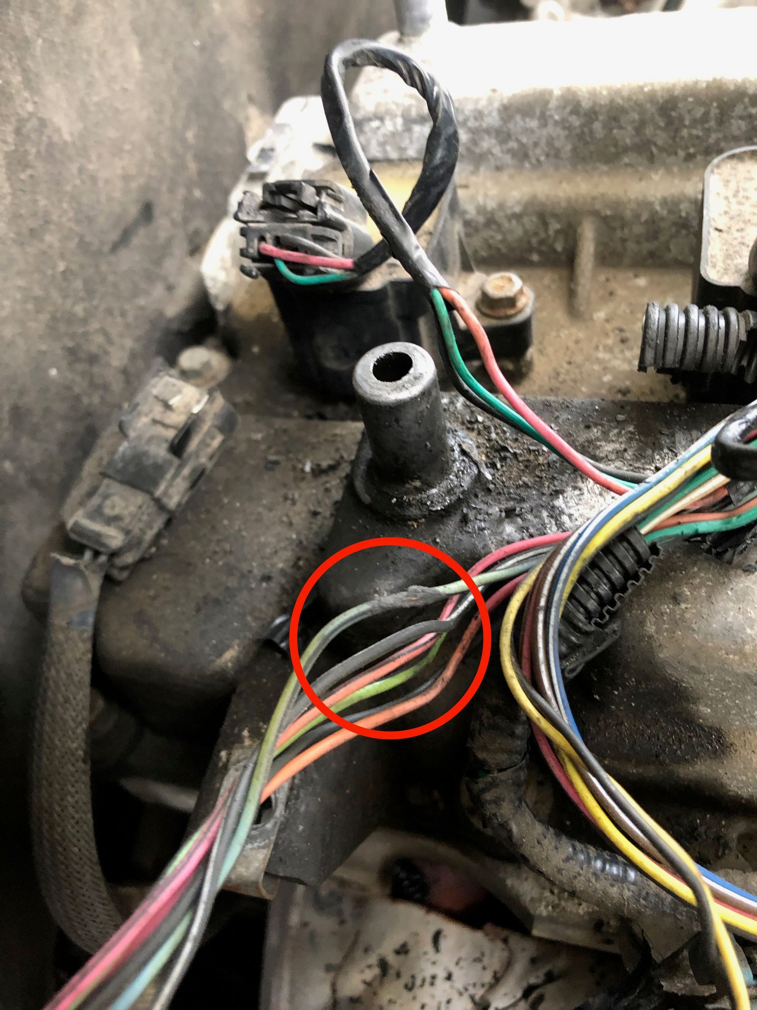

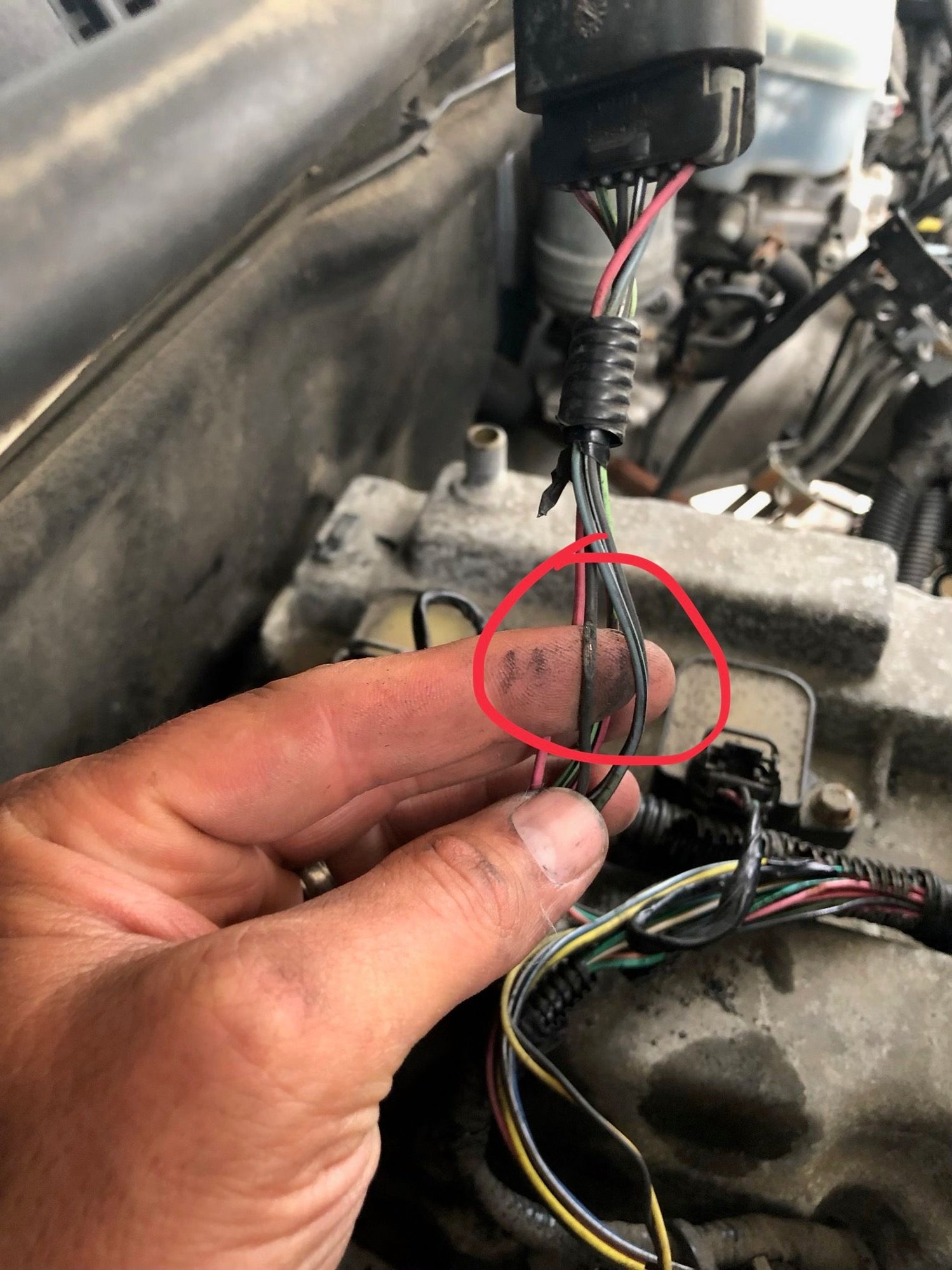

Update... After driving for several weeks the issue repeated itself again yesterday. Today I checked all the wires from the coil to the injector and found 3 wires that had the coating worn off, including on the #1 fuel injector connector.
#1 Injector connector.
harness connected to injector wiring harness. Black wire connects and leads to #1 injector
Green wire has a little bit coating missing
I ordered new wiring connector for the #1 injector. I can't tell if the wire is broke on the inside, so I'm going to play it safe and get a new one to splice and solder. Also replacing all the fuel injectors since I have it all disconnected. It is quite a job to get to them. I had to remove battery, fuse box, alternator, and wheel well to get to remove the plastic part of the throttle body). Took a couple hours just to get to the fuel rail to remove the injectors. I don't want to do that again. Hopefully the bad wiring is the issue... I don' t want to have to deal with this anymore.
I'll update after it is all put back together and I have driven it for a few weeks hopefully problem free!!!
