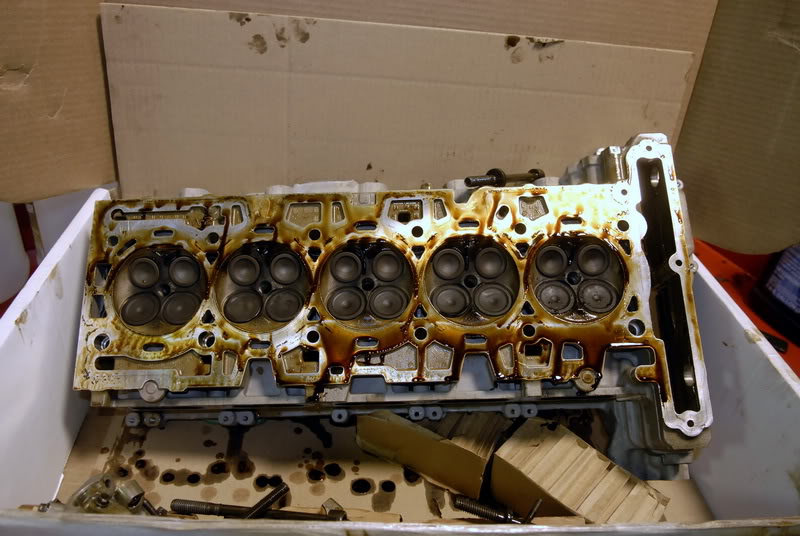

I have to research how many miles my 06H3 I-5 had on it when the head issue came up, I think because of improperly hardened valve seats and a couple of other excuses GM blamed on a supplier, but I was impressed with how clean the valves were with all the off-roading at low speeds I did with it at that time trailering it to off-road parks and not much highway mileage.
