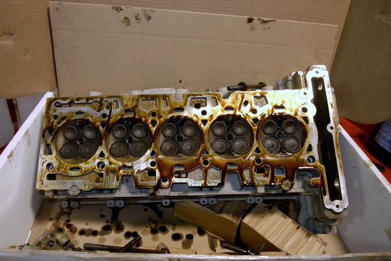

The only true injector cleaning other than adding Techron or similar at the pump is an actual fuel injection service where they remove them and swab them out and use high pressure cleaner in a device designed to do so. On my Cummins they can actually hone the larger injectors to the next size with high pressure driven media. Then they simulate operation and can see the fuel atomization pattern.
But that will cost you.
There is only so much "tune up in a can" will do or even in shop service that claims to clean them by dump/pumping miracle juice thru them, and of course down into your crankcase would only be marginally better, in my opinion.
The rougher idle could be from MASS air sensor problems, either cleaning or damaged if you run an over oiled filter of some type.
Other than that increased mileage could be starting to have some effect like worn valve seats or carbon build up in some cases to the valves are less efficient.
I recommend a long fun scenic trip and sustained hwy speeds with some off-roading thrown in for good measure.
I have to research how many miles my 06H3 I-5 had on it when the head issue came up, I think because of improperly hardened valve seats and a couple of other excuses GM blamed on a supplier, but I was impressed with how clean the valves were with all the off-roading at low speeds I did with it at that time trailering it to off-road parks and not much highway mileage.
