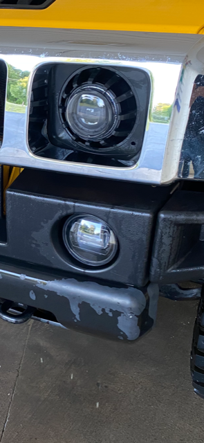

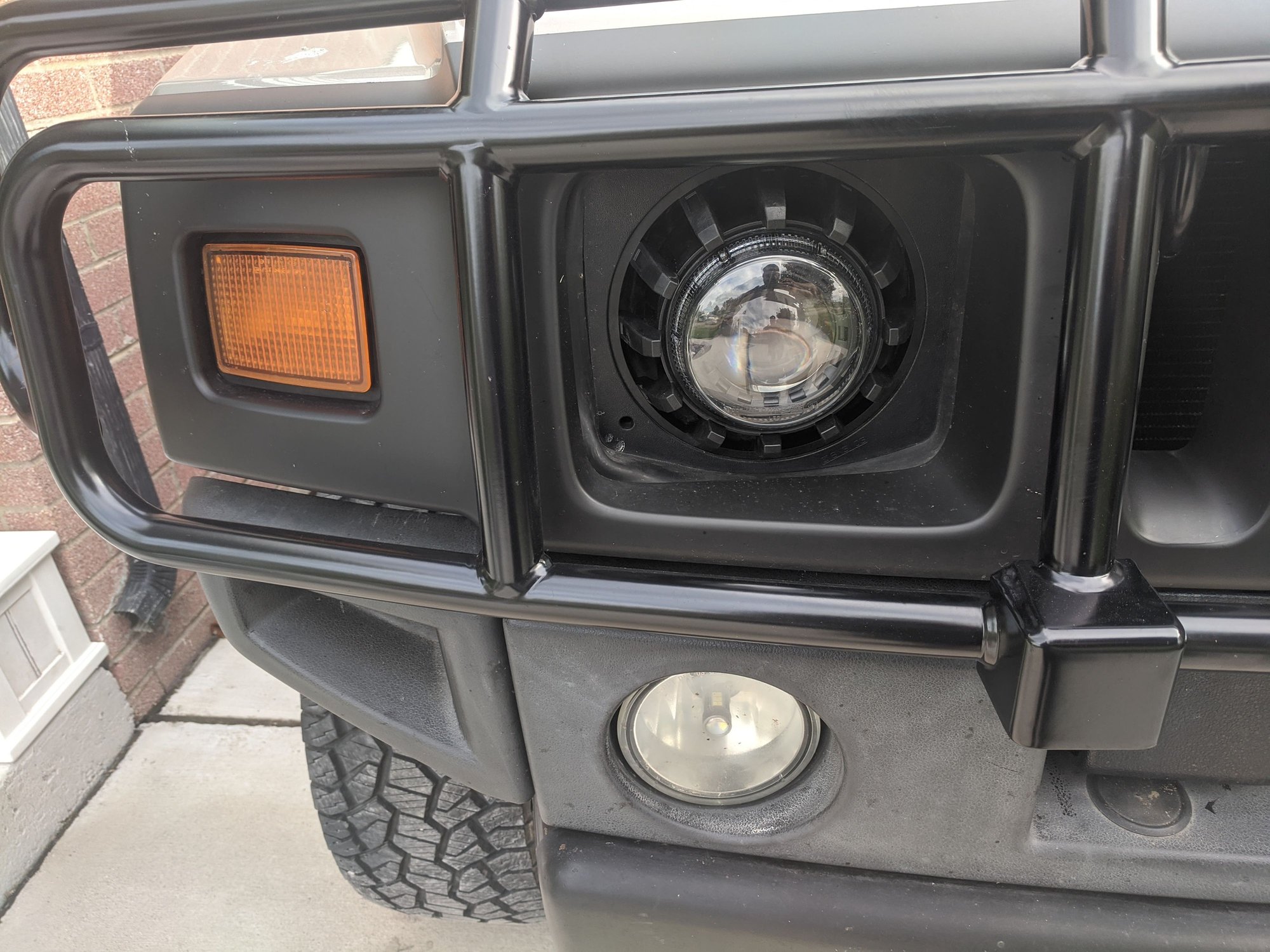

Default Morimoto Super7s
Morimoto Super7s true LED projectors with shudders. A little pricy but worth it. 3 yrs so far no issues. Pretty easy install.
