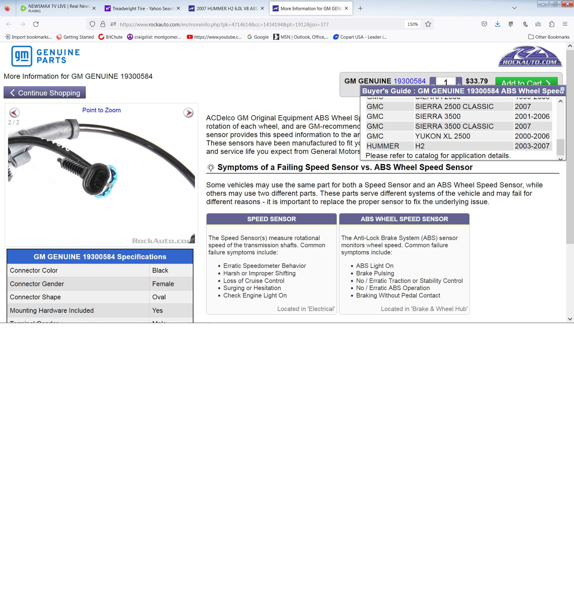

Hassel ordering GM parts for a Hummer H2 which is basically a chevy 2500 truck
I forsee another hassle just ordering parts so ppl don't understand this is a GM vehicle.
Want to replace the left front wheel speed sensor. I've been informed the wires are too thin to splice back together an will send fake infor to the ECU.
This seller says it doesn’t fit.
I believe it doe’s fit. dam
Should I just tell them it’s a chevy 2500 silverado?
https://www.ebay.com/itm/38359184584...&segname=11051

did you confirm the GM part numbers? are they the same? if so order for the 2500. compare the connectors as well incase they differ.

I can’t go by part #s w/ ebay bc it’s a no brand name knock off from a foreign country.
https://www.ebay.com/itm/383591845847
well actuely they refer to there parts as Brand universeparts which everyone knows is counterfeited ebay is fine w/ but theve sold over 160 so it must be a decent knock off.
sure doe’s look like the rock autohttps://www.rockauto.com/en/moreinfo.php?pk=6699608&cc=1434194&pt=1912&jsn=365 attached RA SS thanks
my electroic 4x4 shifting isn't working I think it's bc of the wheel speed sensors wire is cut.
edit:
think I'll splice this wire like it's only 2 inside the sheath.

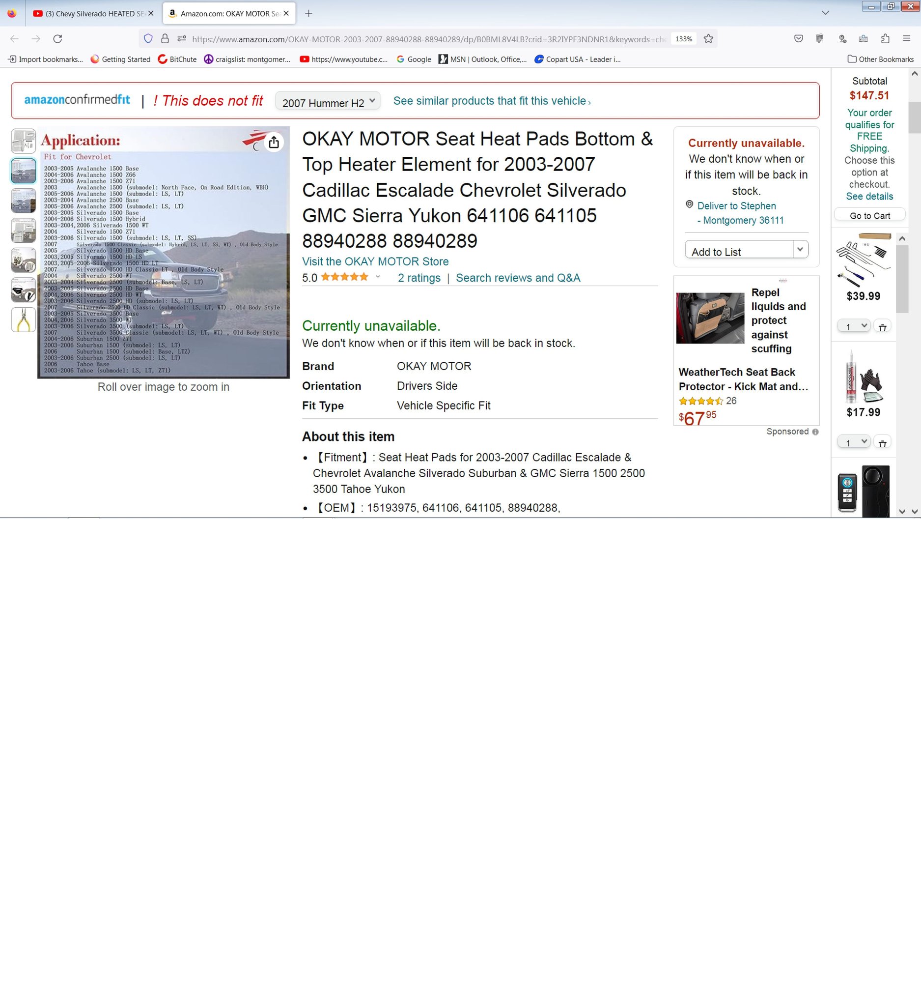

Posts: 3,204
they are different. the H2 ones are stitched into the leather and the leather mounting points velcro / clips to the seat frame /cushion positions are different. but you can overlook that if you wish. i believe the electrical connector is the same then just sandwich them in and hope they stay in place with loose leather.or get creative.
Old Oct 1, 2023 | 03:10 PM
finall's Avatar
Posts: 831
From: Pacific NW
You have to cut the old ones off the leather skins. Then you have to use 3M spray glue on the new ones. You can not just slip them in. Or they will move around and get damaged.
There is a reason they are sewn onto the seat skin.
