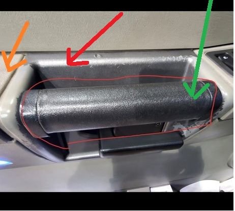

Hi guys!
I read this great thread and was hoping for some additional suggestions/advice.
In taking the OP picture here:
a reply in the thread for the paint color of the RED arrow was this: https://www.lowes.com/pd/Rust-Oleum-...zwXW80&irgwc=1
which I agree looks spot on...
Any suggestions on paint for the Orange arrow color material (wheat/tan?) and the Green arrow material (black)
Thanks all!
Old Dec 7, 2021 | 08:00 AM
calif phil's Avatar
Posts: 2,315
From: Kansas
SEM Vinyl paint, available at most body shop supply houses are what you want to use. Prep is key, and it will work great if you follow the directions.
Old Dec 7, 2021 | 01:06 PM
syphondog3's Avatar
Joined: May 2021
Posts: 25
@calif phil -- what colors would you suggest?
Old Dec 7, 2021 | 01:15 PM
calif phil's Avatar
Posts: 2,315
From: Kansas
If you have the wheat colored interior, I would look for a silver/gray to replicate the OEM color.
Old Dec 7, 2021 | 01:28 PM
syphondog3's Avatar
Joined: May 2021
Posts: 25
But I prefer not to get rid of the wheat, I really just need to touch up the worn wheat color in lots of different areas on door panels and console. Looking for what would the correct "wheat" paint color would be, if anyone knows
Old Dec 7, 2021 | 04:59 PM
SEM might have a close match. If not it might have to be mixed.... https://www.semproducts.com/products/brand/color-coat
Might be able to contact them. I'm sure someone somewhere has a match. The GM RPO code 99 Lt Wheat.
