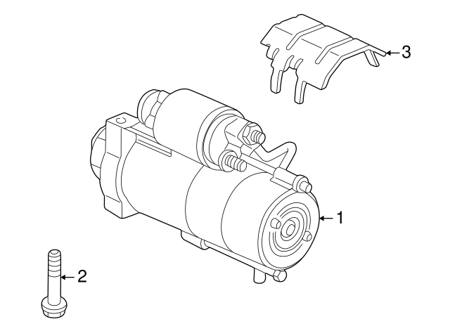

And make sure you have that heat shield over the starter solenoid that snaps in place. It's there for a reason.. .. to prevent exactly what you're describing

Item number three in the below picture. It snaps in place over the starter solenoid

Good point Robert. Folks often forget those during replacements or think they don't matter. Auto MFGs don't add things for no reason.
