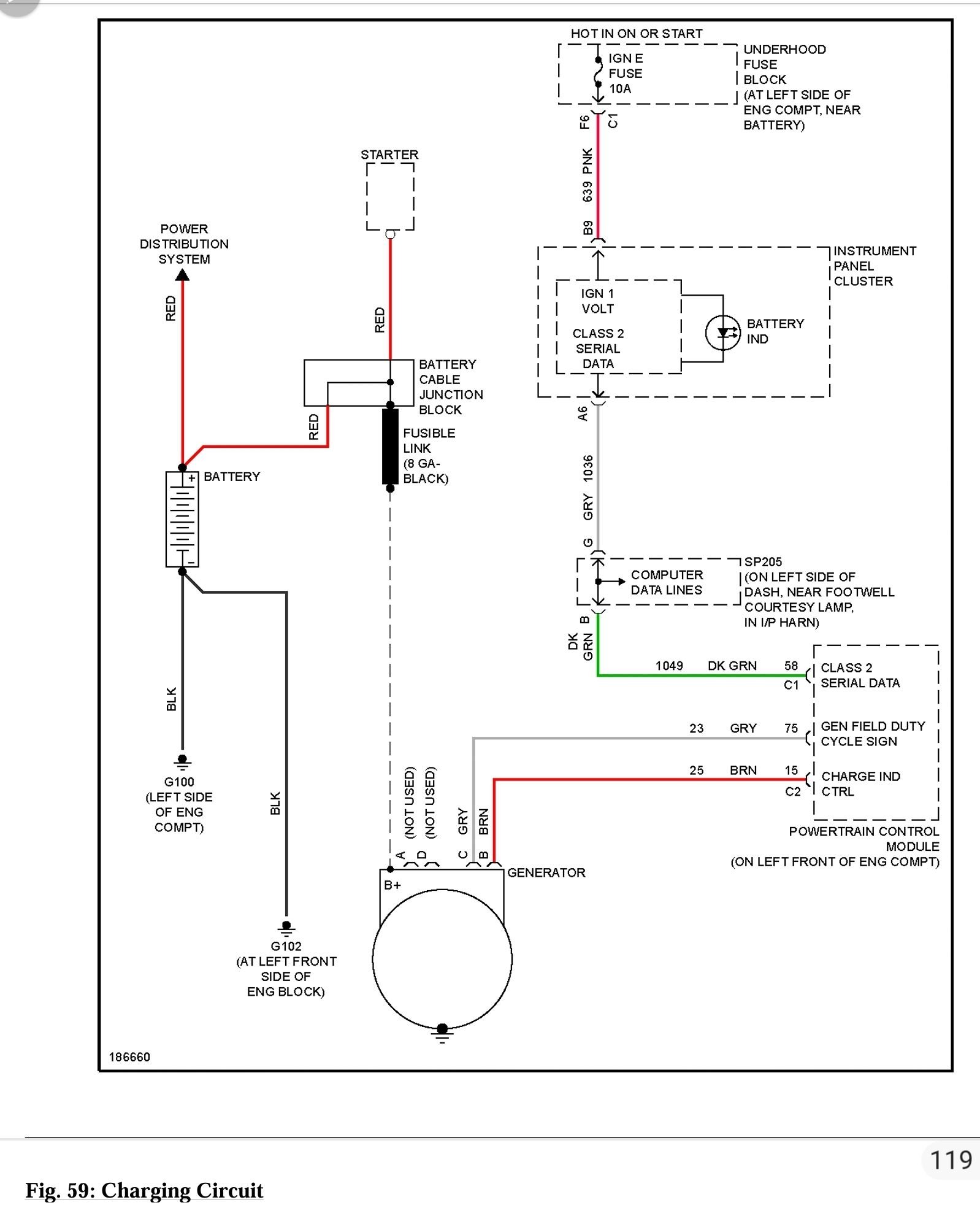

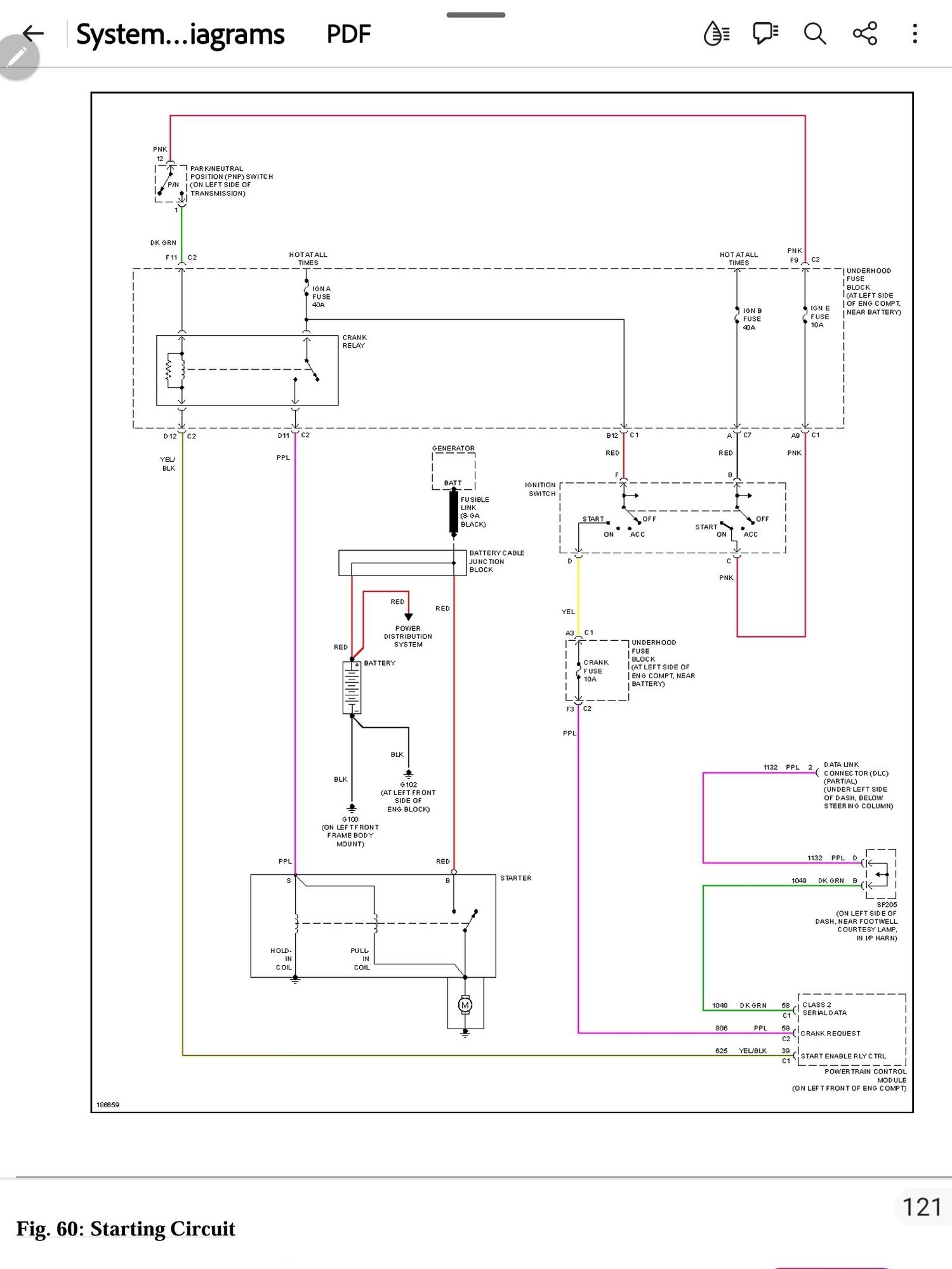

Agree with others thinking probable bad starter/start circuit. Being that the starter works well after cooling it would seem to rule out ALT/Charging ckt as the battery still has charge. That's leaving the starter (gets overheated from running/exhaust/manifold heat) or start circuit. Adding a schematic for you to look at in case you are mechanically inclined. Clean up all the battery (+ & -) cable connections where they terminate at the engine block, starter and frame.
