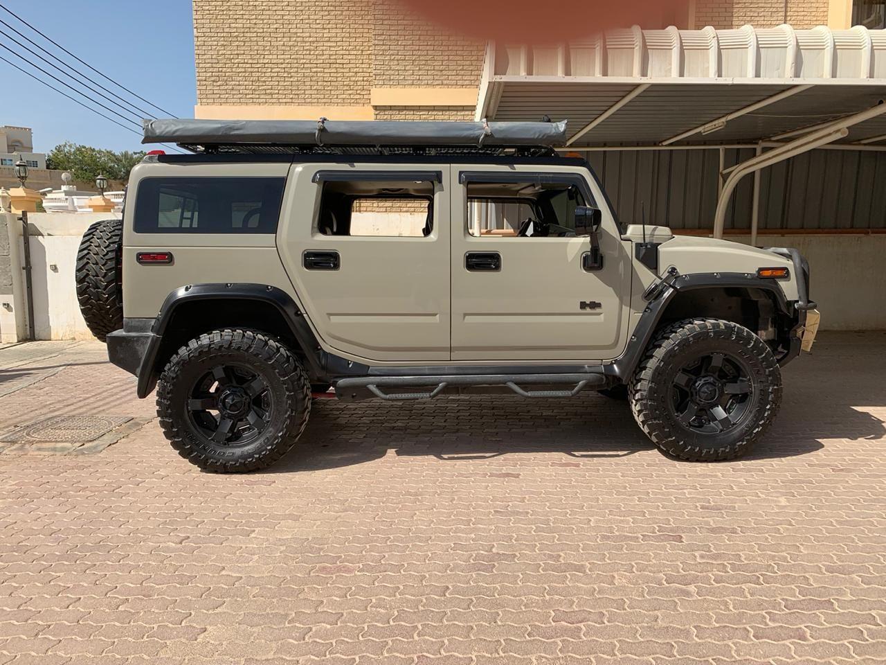

Posts: 46
Originally Posted by Billy Berry
Good luck with this, I bought my H2 with 40's and 2 inch wheel spacers. It only had 41k miles on vehicle and the wheel bearings where destroyed. It has a 6 inch lift, but I went back to 38's and set of rims that I wouldnt require spacers. Most seem to like it considerably better. Ill try to attach pics later
38" is perfect balance for the H2 with 4.88 gears, here is mine.
