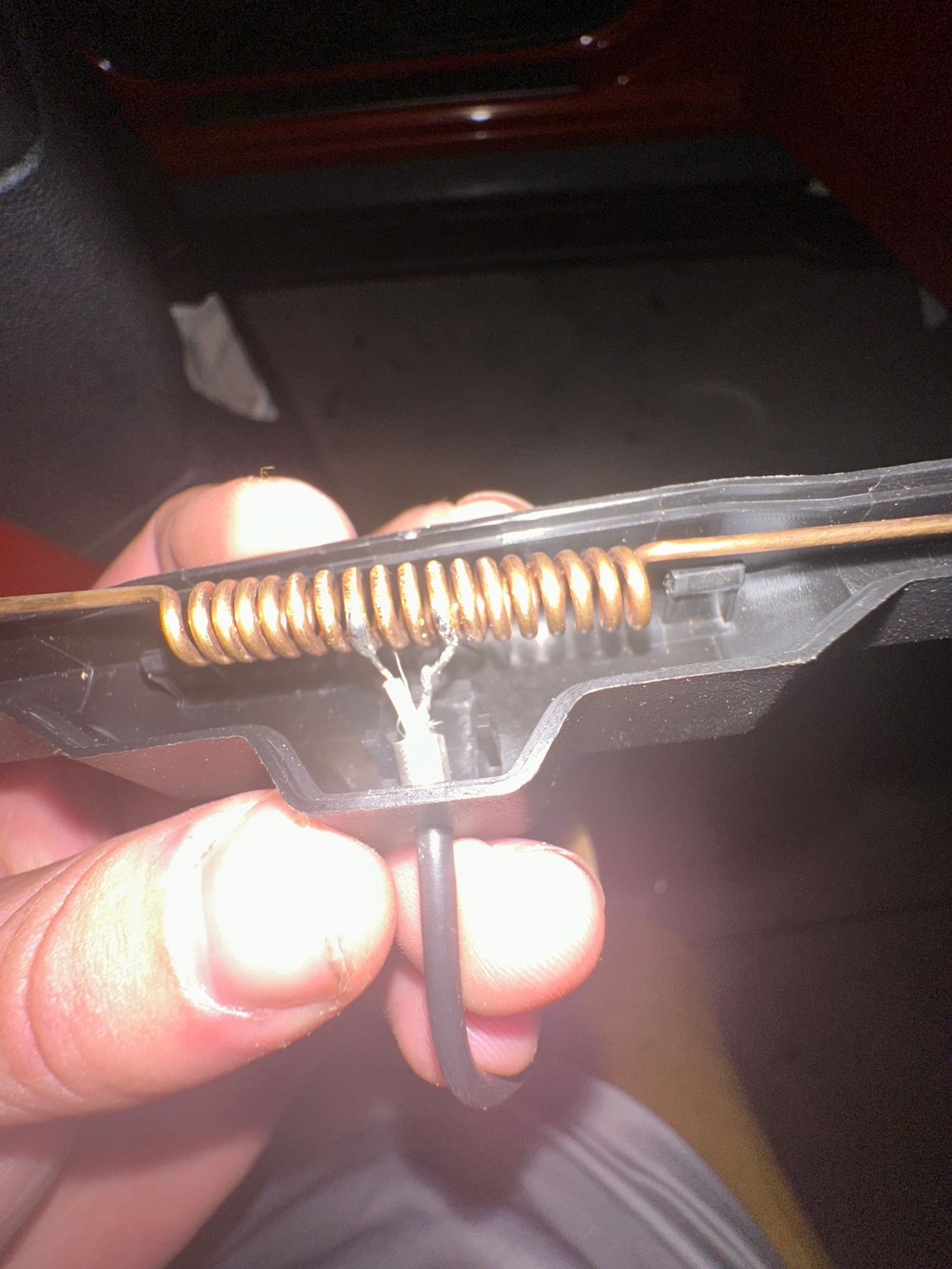

Parts cannoned the rcdlr and antenna last night… and of course it had to be programmed with sps before the keys could be learned. No biggie though. The VCX nano worked without a hiccup today. I may have found the root cause of the issue. You’ll see in the pictures where I took the a-pillar antenna apart, there’s a little stray stand of wire from the cable on the right that’s shorting to the cable on the left. Oddly enough I had no remote range issues. The only issue was at first the TPMs light would come on only over large bumps, but later returned continuously.
I replaced this antenna along with the rcdlr. The antenna is located in the driver a-pillar, accessed by prying out the rubber on the front of the grab handle and removing the 2x8mm bolts. There are no clips that hold the handle or a-pillar in place.

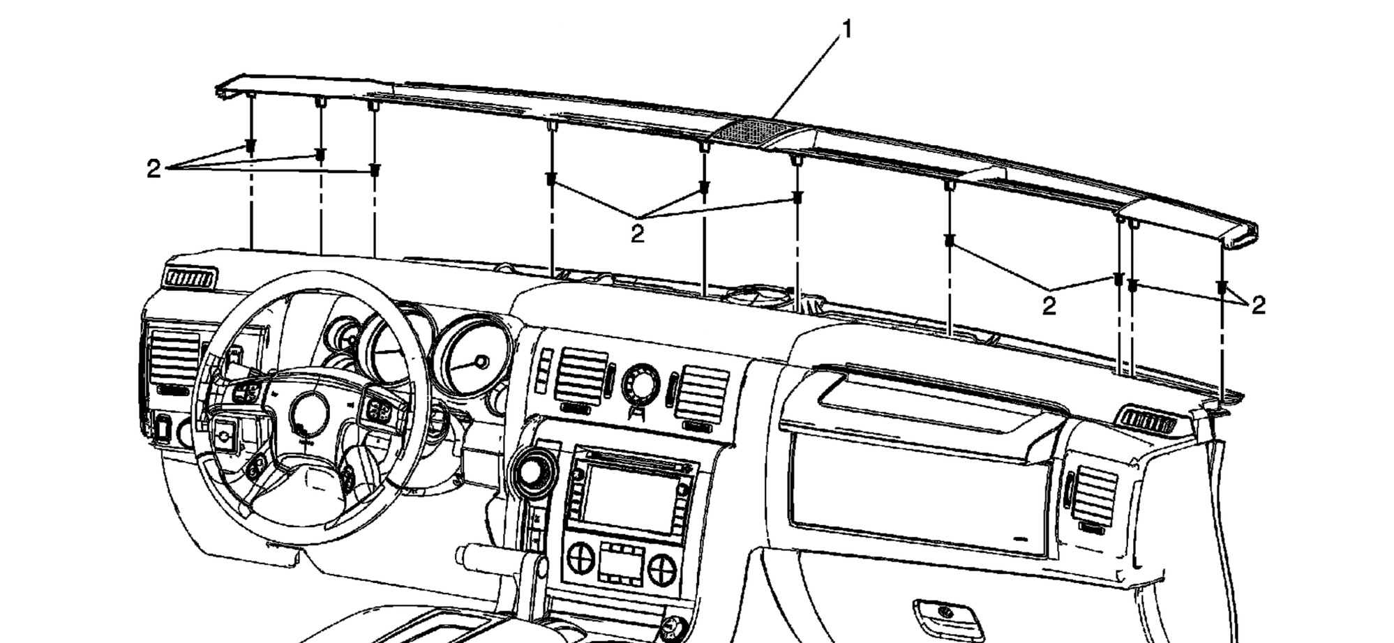

Next, to access the rcdlr, the passenger side a-pillar has to be removed, that way you can pry up the brittle defrost vents. The clip locations for the vents are as shown in this diagram… they are all on the inside side of the piece(closest to the driver and passenger)
the “1” indicates the ambient light sensor. This is to be removed after removing the vents. It is not a clip. I started left to right on the clips with a nylon pry tool and a microfiber underneath to avoid denting the squishy pleather. This was absolutely the worst thing I’ve ever had to do. The clips are tight and the plastic cracked in two places, though it was minor. I also broke two clips clean off the plastic. There is no avoiding this I was as careful as possible. However if I did it again, I would have started from the outside clips and worked my way in one at a time.
Once the plastic is removed the rcdlr, located in front of the steering wheel can be removed. It is just clipped in and you can remove it by pulling up and toward you so it tilts and pulls out. Next, I routed the antenna cable underneath. It can be snuck under the front between the windshield and the plastic.

After all this I put everything back together and programmed the module using a vcx nano and sps and 100% legit software I definitely paid over $1000 for because using the hacked software included with the nano is illegal and morally wrong… fosho
I did have problems pairing my driver front TPMs sensor by letting air out, but I have the TPMs tool coming tomorrow so I’ll try that out. I never had any problems with this sensor as it was working fine before I started. Just the right rear wasn’t reading and that sensor is known good. If the front sensor is bad, I bought a TPMs emulator from here…
