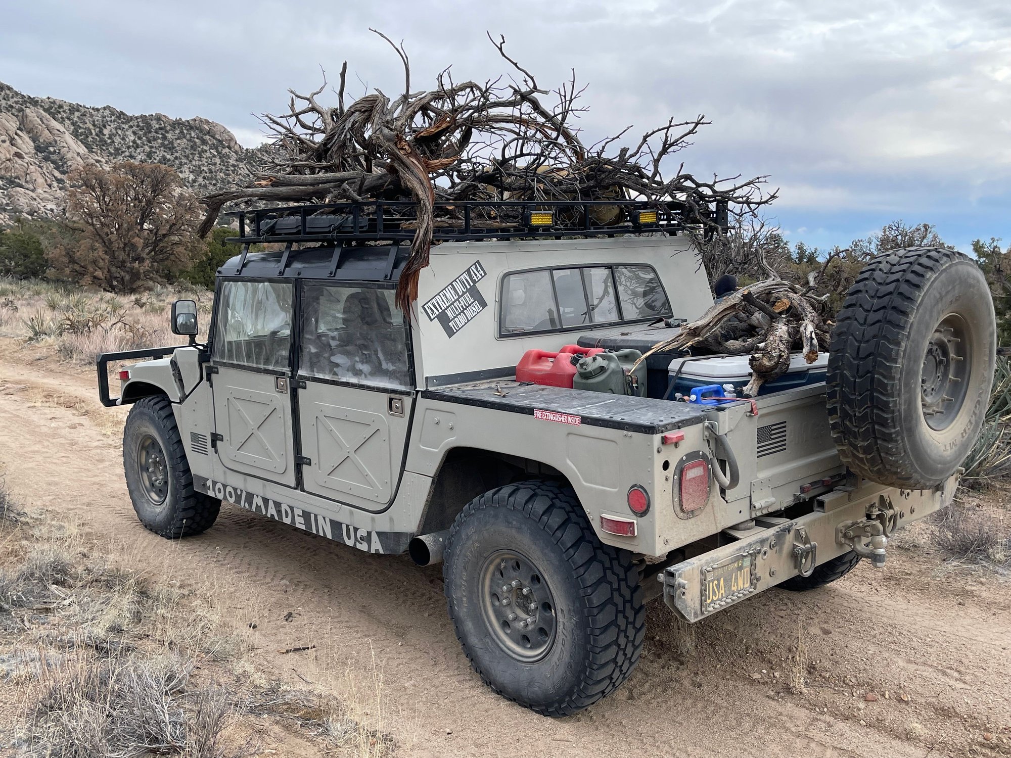

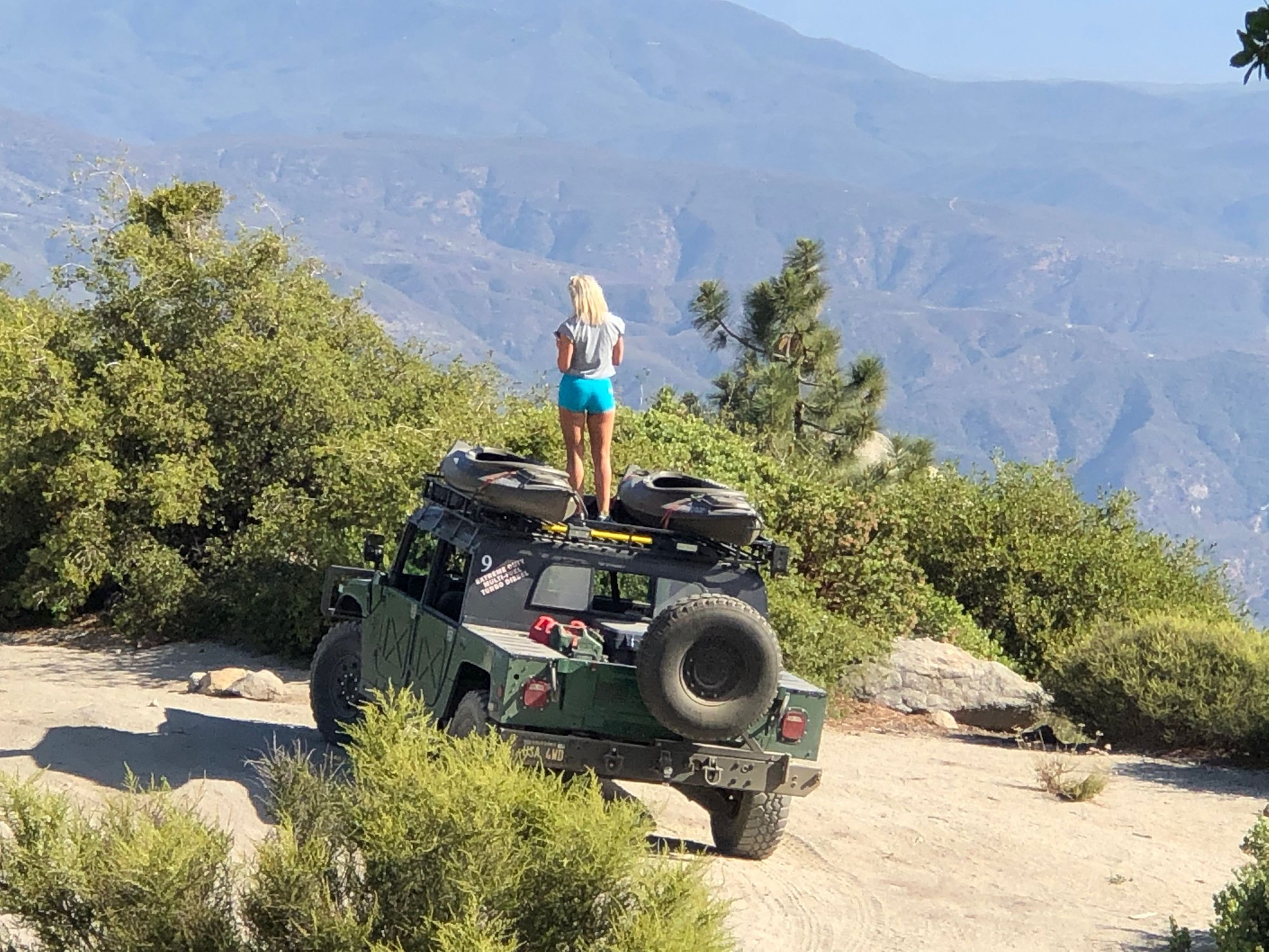

I am concerned about roof rack cross bars.
looks like this thing is attached to the plastic piece with two tiny screws on each side,
how’s is this safe to have 200 lb weight bouncing up and down on washboard roads ?
i am working to adjusting myself that this is not an H1 to be able to stand on the roof or hood or hold 1500 lb on the roof.
but getting there slowly.
