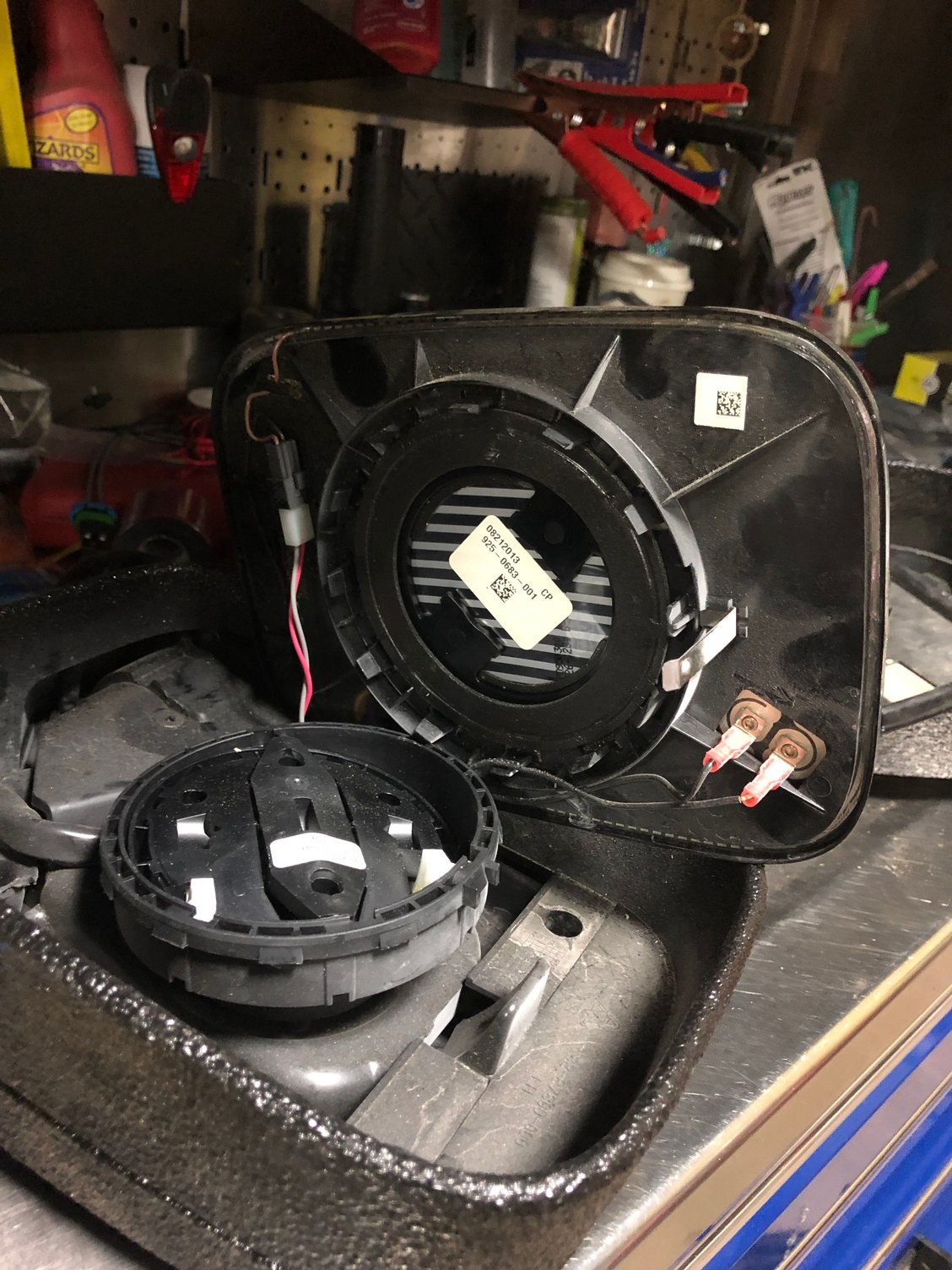

I noticed that about mine and assumed one was original and the other was replaced with aftermarket. Actually I removed the mirrors and found out the guts r different too.. 1 (driver side) has 2 connections and the passenger only has 1 connection. I was told the 2 connection mirror is for heat and auto dim feature so I guess the passenger is just heated or auto dim only. Not really sure. When I get to my shop in tomorrow I will send pictures of both mirrors to see if they are identicle to yours. Have you looked at the guts behind the mirrors?
This is passenger mirror with only 1 connection. Guessing it’s for heat...
This is the back of the passenger mirror with only 1 connection
This is the driver mirror with 2 connections (heat & auto dim)

I just read that the auto dim works off of 1 sensor which is located on the left mirror so hopefully that is correct and would explain why left mirror has 2 connections (auto dim heat) and right mirror only has 1 (heat)

The drivers and passenger mirrors are constructed differently. For the 07/08/09 series the following are true:
* The mirror motors are identical (part 19167560). They are just oriented differently when installed. This motor is different from the 03-06 mirror motors.
* The drivers mirror (part 19167555) is flat and heated. Due to the heater, there is a plastic ring glued around the mirror glass. You will know it has been replaced when there is no ring around the glass OR if it is not heated and does not support on the connectors -- new replacement glass is NOT heated. OEM glass will also be manufactured by Gentex and will have a number etched at the center bottom of the glass that begins with "GNTX"
* The passenger mirror (part 19167554) is convex for a greater field of view and does not have a heater. It does not have the plastic ring around the edge and you can see that the glass is just glued to the plastic backing plate.
ALSO - for those of you planning to upgrade mirrors... the issue with the early series mirrors is that the motor is at the bottom of the shaft to open and close the mirror. Since the mirror assembly is NOT water tight, water accumulates around the mirror motor and eventually kills it. The updated 07-09 mirror has the motor at the top of the shaft in a fairly water tight enclosure (see pic #4 below).
