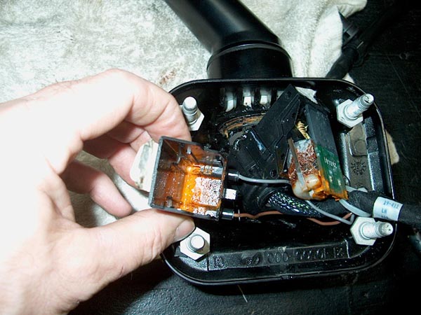

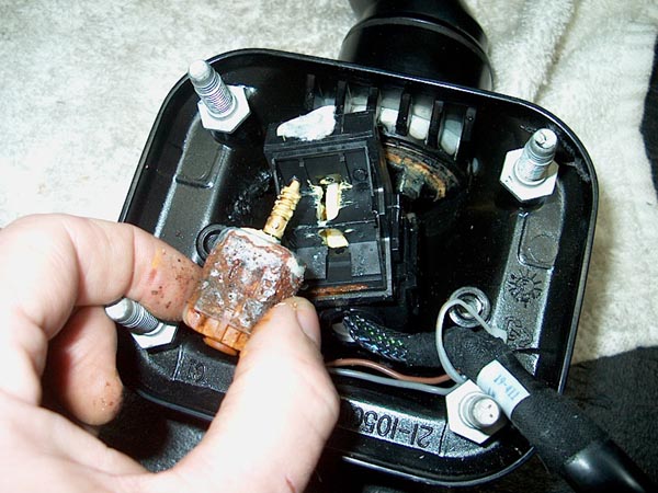

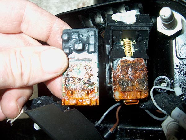

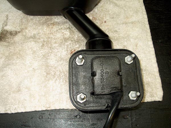

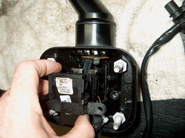

Here are a few pics of the mirror motor on the H2's.
Attached Thumbnails Passenger folding mirror-001.jpg   Passenger folding mirror-002.jpg   Passenger folding mirror-003.jpg   Passenger folding mirror-004.jpg   Passenger folding mirror-005.jpg
