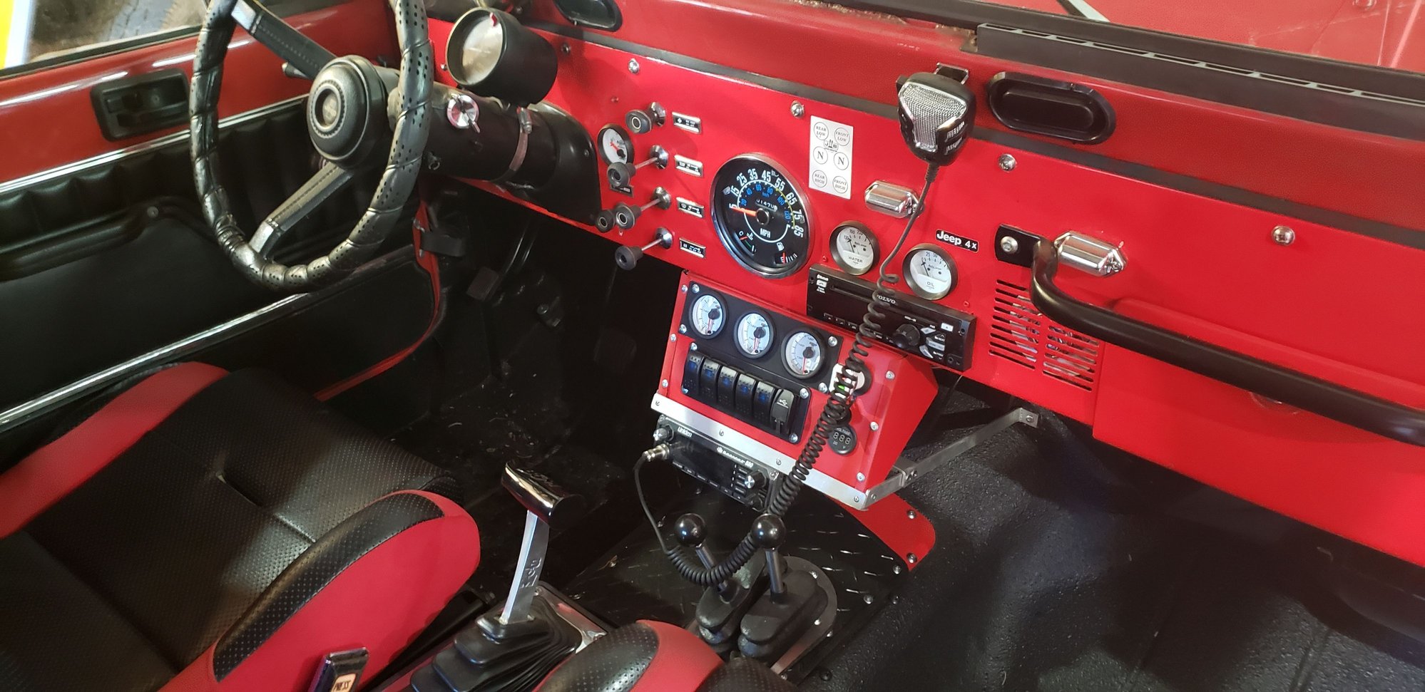

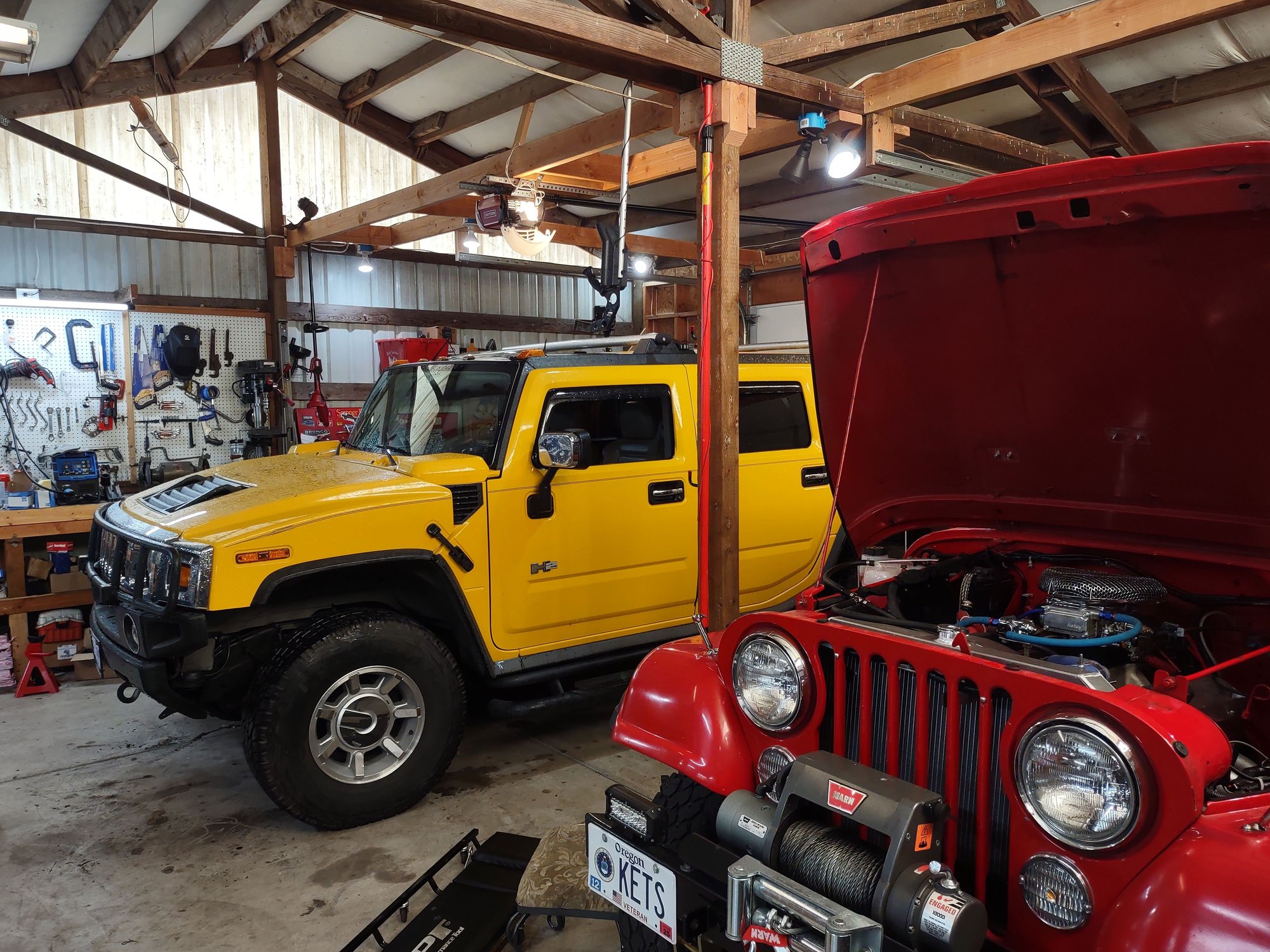

LOL, so which one do you think I actually prefer working on?
2 years ago I finished building the 1986 CJ7, with a generation one small block Chevy, Edelbrock performer manifold and Holly 600 CFM. Built a turbo 350 transmission..... Built my own harness and replaced all gauges, complete drivetrain rebuilt. No computer crap, and it simply just works. Why can't they build anything that reliable these days?
But the Hummer really is in a class of its own. I find it more comfortable than my wife's 2014 Escalade. (So does she!) I've gone through the Hummer as well, it's actually been extremely reliable. And in a wicked snowstorm going over Santiam Pass in the middle of January, it's no contest..... The H2 is quite stable and has never failed to take on anything I throw at it.

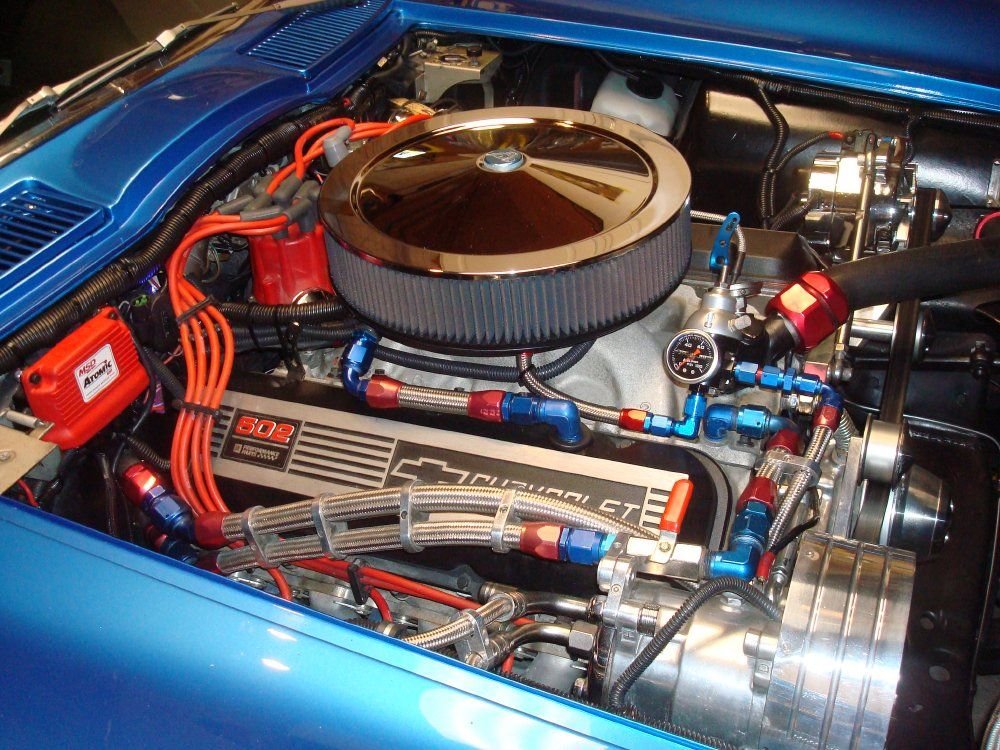

Nice Jeep... And your right..I've thrown a lot of ruff roads and weather conditions at the 2. The Vette is sweet but I still feel the safest and the go anywhere feeling in the 2.
I still keep my Sunpro timing light and dwell meter hanging on the wall!
And yes, I have all my old school stuff to do a 1965 tune up on the old gack. I must digress... I still like tweaking the old stuff.
But the Vette gives me that Rush when you stomp it in 2nd. I can't do that in first or I'd be picking up chassis parts.

Very, very nice. And it even looks like an engine. Not hidden under flimsy plastic coverings. Back when intake manifolds were actually made of metal, LOL.

I Like the part about the intake Manifold...LMAO.....But.. Who puts a Marine motor in a car? I Do...L.O.L. The 502 you see in that pic is Gen #1. Has No Meck Fuel Pump Boss..and No Clutch Cross Shaft Ball stud to mount a Shaft. It was developed for Marine use. GM took a 454 and stroked it to 502 CID. And then installed a roller camshaft. But oddly enough the used stamped steel rocker arms????
The whole idea was that the motor produced 570 Ft Lbs of torque at 3800 RPM where boat motors like to run at. 502 HP came in at about 4800 rpm with a red line of 5500. GM started selling a bunch to Chevy dealers. They were miffed so they called a Chevy Dealer up and asked why they were buying Marine motors.
The Dealers told them to get with the program as all were going into Hot Rods. So GM started the 502 Gen series...now up to Gen 6. They now come with Fuel Pumps and ball studs for the clutch.
You can feel the torque when you step on it. One company made an adapter plate for the Ball stud so you could use a clutch set up. The fuel pump issue was solved using a (at the time) Carter $79.00 electric fuel pump mounted on the frame rail behind the rear tire.
Now using a "Tanks" Fuel tank with a Waterboro in tank EFI high pressure pump. It does have Edelbrock Intake and Heads. GM likes to use there stuff
