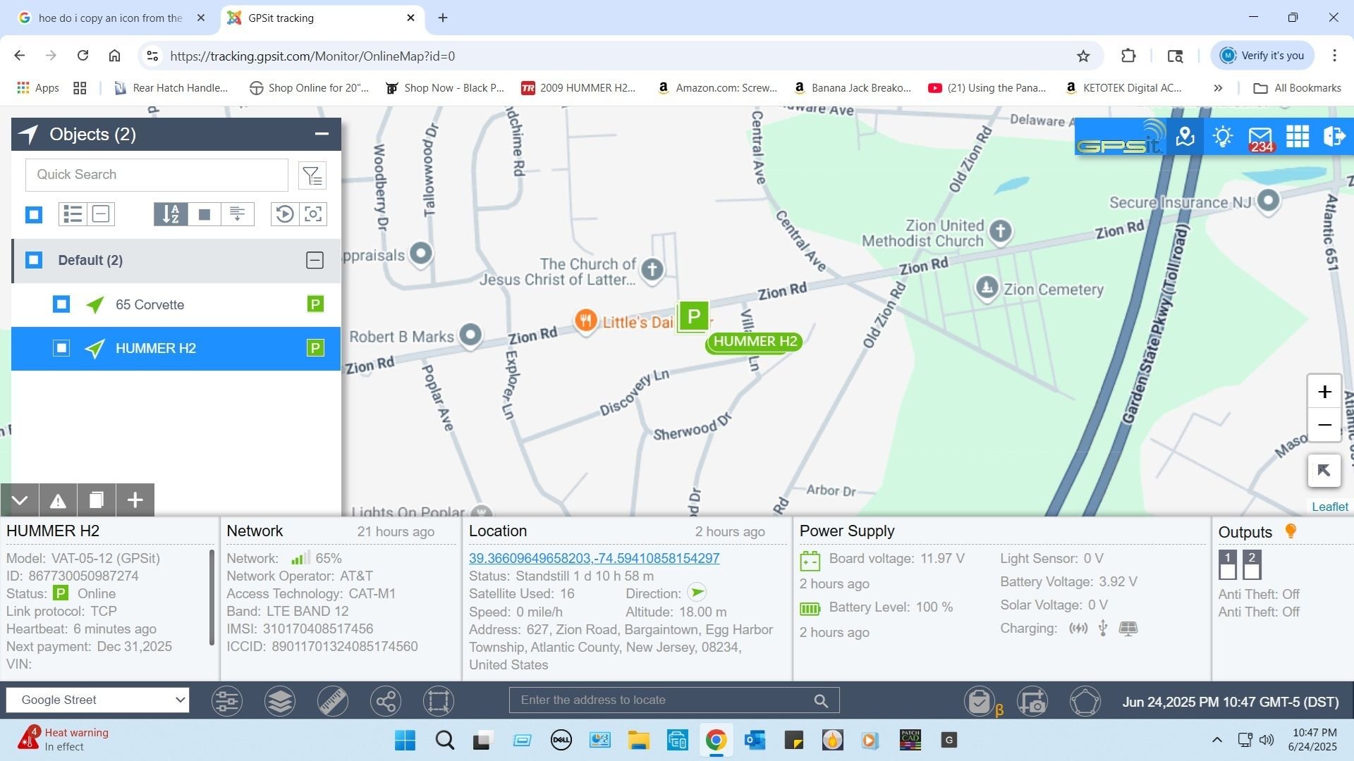

Yeah It works well. When I park I just move my left foot over and step on the little switch which has the little 1/4 Black button about flush with the floor. I have a red L.E.D. that comes on that is wedged in the A pillar weather stripping so I know its on. Of course you can test it my trying to pull the shifter out of gear. But in a dynamic situation you just want to get TF out of the rig. So speed is best. The perp.... can't see you do anything with your hands as your foot is dancing over to the button. L.O.L.
The best part is if the rig is taken...I know where it is by my phone track app and I can send a signal to trip the lock out with the push of a button. Here's a screenshot of the tracking. On the lower right are two buttons labeled ..outputs. #1 sends the signal to lock the shifter. Not Paranoid am I...LMAO ​​​​​​​
