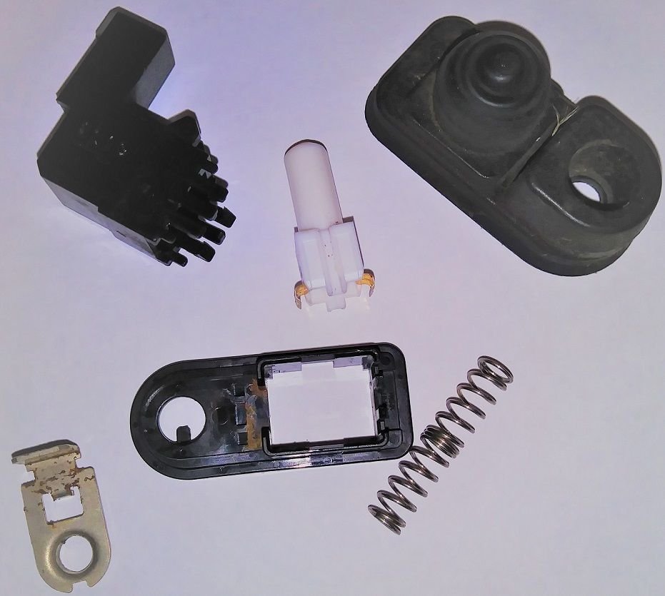

Twice I had a door jamb switch fail. Rear door, I disconnected switch and cleaned the contacts on the switch and connector with CRC electronic contact cleaner, fixed. The passenger rear door, I tried the same, didn't work, so I took the switch apart and found 1 contact in the switch housing was green, cleaned internal contacts and put back together, fixed.
If it's a good new switch, check the connector/wiring. In the future before you purchase another switch, swap 1 from another working door.
Btw, there's only 6 parts to the switch, easy to take apart to clean contacts:
