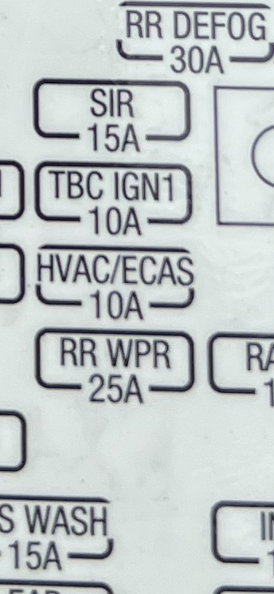

Here are the details. I finally had the chance to check it with my voltmeter.
using negative side of the battery. Battery is 840cca. Tested good with 800cca still.
when first connected I had a 2.9 amp draw after a minute it would drop to .075 A. After going through all the fuses one fuse knocked it down to .010A. That fuse is a 10A fuse marked HVAC/ECAS.
No other fuse made a noticeable difference like that one. Next I need to isolate what is on that circuit and disconnect each item individually to see which is item is causing the draw.
I am assuming the compressor and electronic air conditioning control unit head is on the circuit. About a year ago or so I swapped out electronic climate control unit with the Dorman from Oreillys. It seems to be working properly but maybe something is going on with it. I just wanted to share my update. If anyone has any suggestions please let me know.
