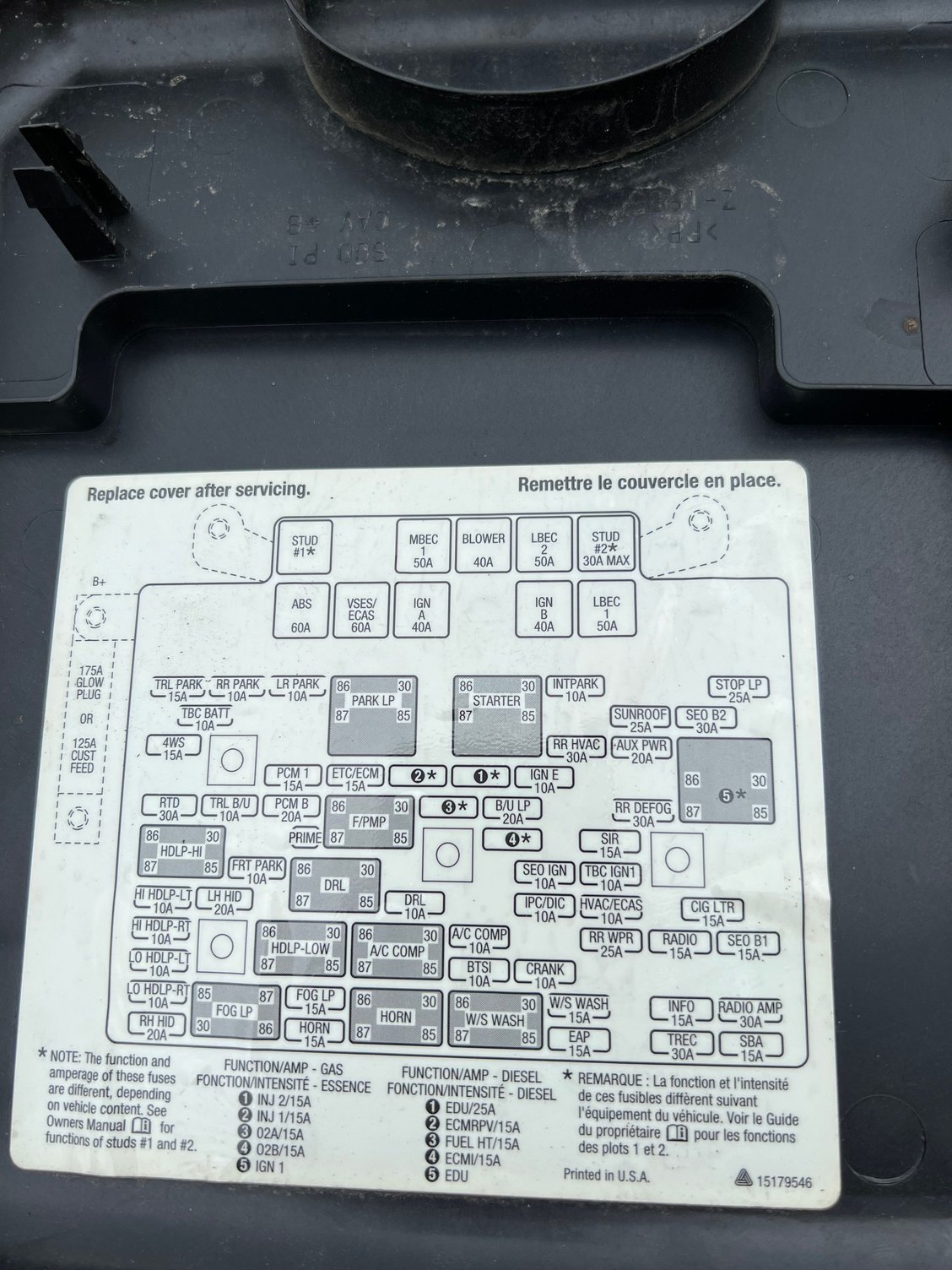

Remove the VCIM fuse from the underhood fuse box. That is the old 3G Onstar module fuse (vehicle communications interface module). It has no use since the 3G Onstar system no longer works but the module is still active in the car and trying to find a cell signal. That is one draw for sure I know of.

Any chance it would be under a different name VCIM? I couldn’t find one labeled that.
