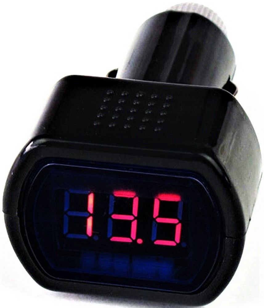

DISCHARGED BATTERY SHORTENS THE LIFE OF THE BATTERY!
Monitor the voltage. Keep in mind short trips does not fully charge the battery. I use a cheap
LED Digital Voltmeter LED Digital Voltmeter
that plugs into the cigarette lighter to monitor voltage. When the volts dip low, I connect the battery charger and give it a few hours on a 2amp charge.

Thanks hummerz , actually I have one of those, pretty much the 1st thing accessory I ever bought, funny thing was I thought it might be that draining my battery.
