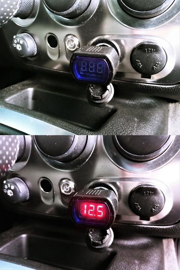

Well, my LED Voltmeter looks identical to yours (cases are the same anyway) so here's a picture interesting.
The little 12V meter's current drain data is 40mA at 12.7V. A few other figures are:-
  • 10.0V = 29.5mA
  • 12.0 V = 37.3mA
  • 14.5V = 47.2mA

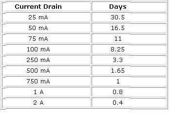

Returning to parasitic drain this what the GM manuals says:-
  • The battery run down time will vary depending on cold cranking amperage (CCA) and reserve capacity (RC). If the CCA and RC are higher, then the battery run down time would be longer. If the CCA and RC are lower, then the battery run down time would be shorter. The graph below indicates roughly how many days a 690 CCA battery with a 110 minute RC (60.5 AH) starting at 80 percent state of charge will last with a constant current draw until it reaches 50 percent state of charge. Differences in battery rating and temperature will affect the results.
and here is the table they list:-

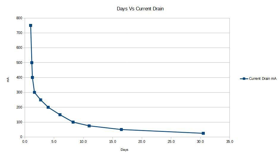

Putting in perspective, and extrapolating a little, here is the above expressed as a graph:-
So assuming a parasitic drain of 25mA for the truck, plus 37mA for the little meter, this is 62mA and works out to be around 13 days i.e. about half. Or for just the little voltmeter alone 20 days.
I managed to find GM bulletin #02-06-03-010A on Battery Parasitic Drain, they quote a typical drain range of 7-12mA and a maximum of 30mA
According to my math 10mA would be about around 40 days.
