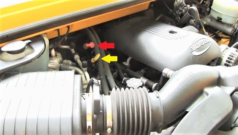

Perfect. Under the hood which one is the one to check how much oil is in it? I couldn’t find it

It is called an oil dipstick. Check the oil level with that. The oil in the lines is your motor oil.

Oil Level Indicator found here(Yellow engine, Red transmission):
HowTo Check Oil Level Hummer H2
