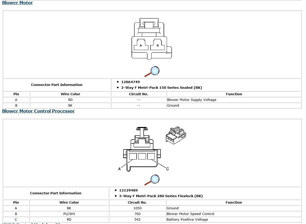

After replacing the updated resistor twice with still having blower problem, looking to change 5pin back to old 3 pin but need help with wiring. The pigtail is all gray color wires. A guidance would be appreciated.
Old Nov 8, 2021 | 08:34 AM
Old Nov 8, 2021 | 11:16 AM
cko1009's Avatar
Joined: Jan 2021
Awesome!! Thanks a million~
