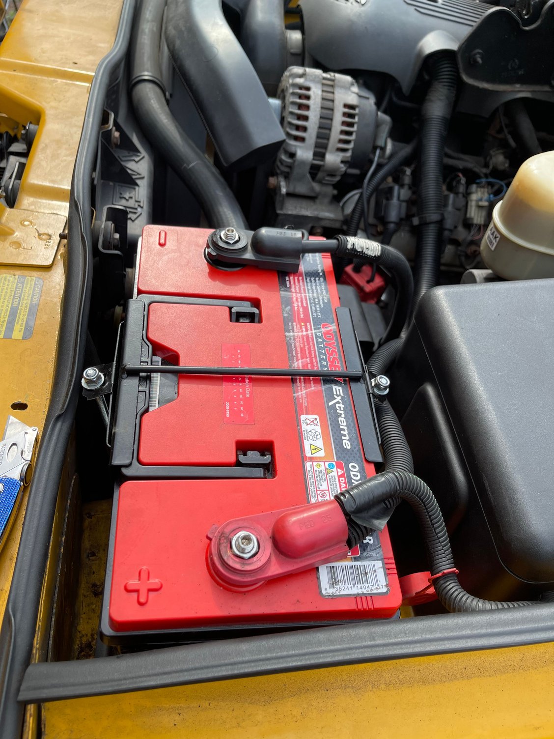

you can fit bigger if you want.

Now that's what I'm talking about! I'm assuming you bought an aftermarket battery tray and bolted it in? At least that's what I was planning. What group number is that battery?

31R>>>>>>>>>ODX-AGM31R
Old Feb 2, 2025 | 04:21 PM
Posts: 3,217
https://www.odysseybattery.com/produ...y-31r-pc2150s/
thats the battery.
and i just used an off the shelf hold down from autozone top bar with 2 "J bolts".
i had to move the engine ground up one hole on the block to get the reach to the top. there is a free threaded bolt hole closer to the manifold below the temp sensor area. almost in line with the original location.
the factory terminals fit the 3/8 studs.
clearance to the hood rubs a bit but just rubs barely a blonds hair as a cant say ****s
the reason for using this battery was my old ACdelco finally was on its way out and i was gifted this brand new commercial truck battery. they use them in parallel / series (depending if 12v or 24v systems) on internationals and mac trucks well maybe even more trucks. but there fleet consists of those.
