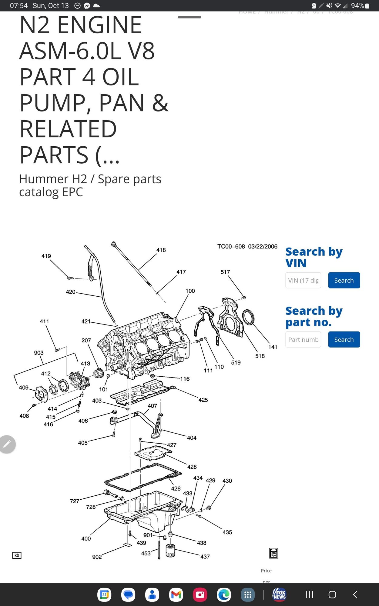

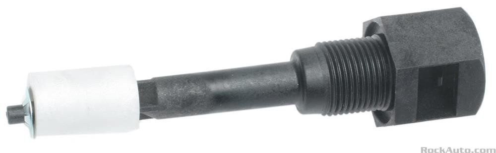

H2s have the Oil Level Sensor. When they get crud built up, or just get old, they can cause false warnings. #427 below, PN 19112977, they are about $21 at RockAuto
Old Oct 11, 2024 | 11:18 AM
Might want to check the connector and wires to it, hit the connector and sensor with CRC Electronics Cleaner first?

It's $22 and some odd change for an AC Delco one on Amazon. That's what I used on mine.Heres the link: Amazon
I would just put it off to your next oil change, it literally takes 2 minutes to change it out. Threads are plastic so don't go crazy torquing it down.

Not sure what year yours is, but unlike Doc's, my 03 OLS is on the right side of the oil pan (#727). Same part tho...

I think doc might have been trying to pull a fast one to see if we're paying attention, LOL.
His diagram looks like a small block Chevy....
