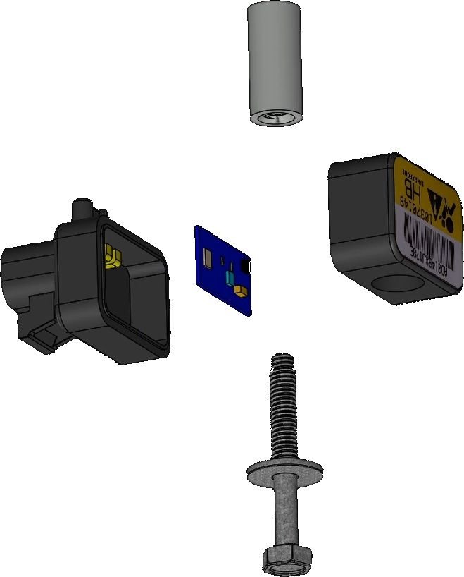

front impact sensor availability has become a major problem.
They usually fail because water and corrosion invade the sensor causing the electronics inside to fail, sadly there are not substitutes yet.
The design is upside-down as mounting tube forms a moisture trap.
