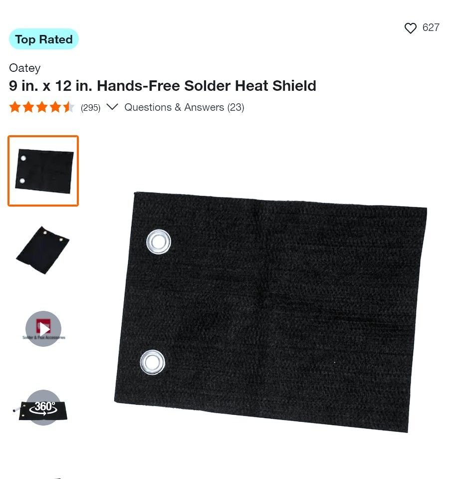

Old Jun 21, 2025 | 05:55 PM
Posts: 9,046
Old Jun 21, 2025 | 06:22 PM
oceanbrave's Avatar
Joined: Feb 2015
Posts: 1,635
From: Birmingham (UK)
Useful info, thanks for that🙏👍
