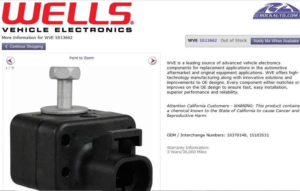

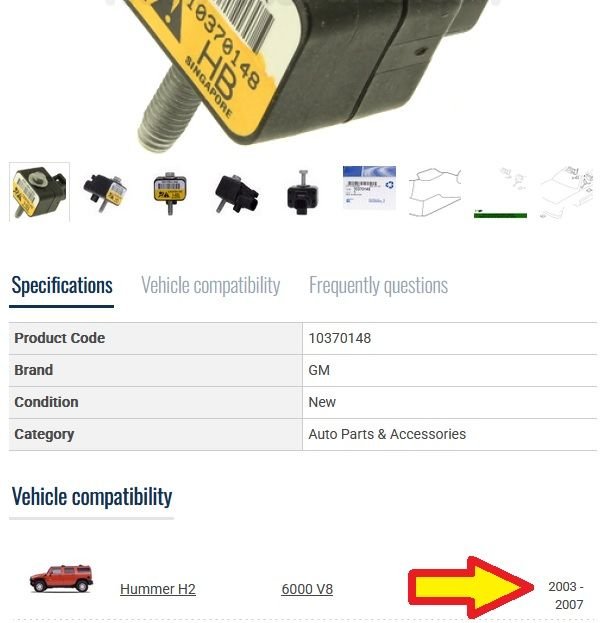

Posts: 9,046
Old Feb 16, 2025 | 07:28 PM
Posts: 3,217
the part number got superseded by newer part numbers as the years progressed.
