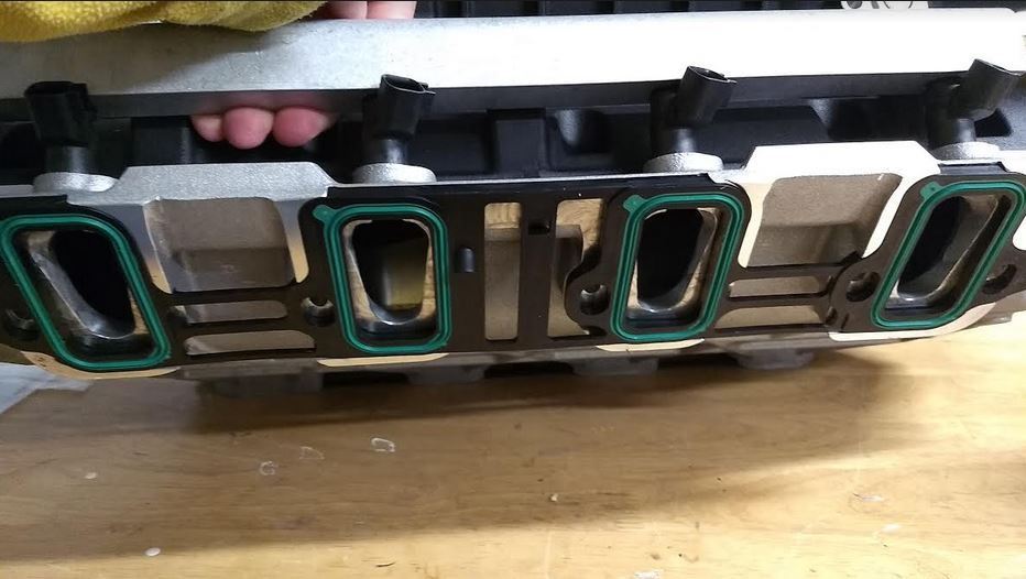

MAHLE MS 19598 gasket fits the super charger. It was a tight fit and took some coaxing w/ a rubber mallet:
You can see the difference in the shape of the ports.

At first glance the SC ports looked like they were for the earlier cathedral port LS blocks like the 03-07 H2's.
I assume they shaped them that way intentionally for better laminar airflow. Looking forward to hearing what your thoughts are once you have it installed and tuned.

Maybe they didn't want to redesign it.

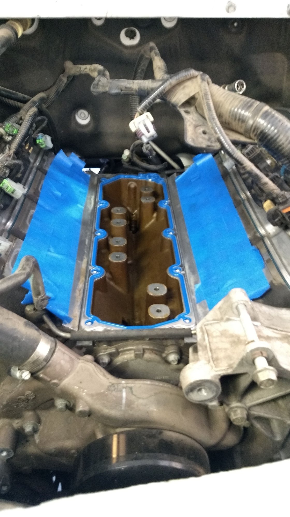

Finished the install last night. It took 3 of us about 15hrs. The instructions are not exact and we had some fitment issues that we needed to overcome. Here are some images during the process.
I replaced the valley cover gasket and o-rings. Get the felpro kit that includes the o-rings.
I also replaced the the oil sending unit which was a good idea b/c the super charger sits right up against it so it'll probably take removing the supercharger to get that thing out in the future.
Here's towards the end of the install
