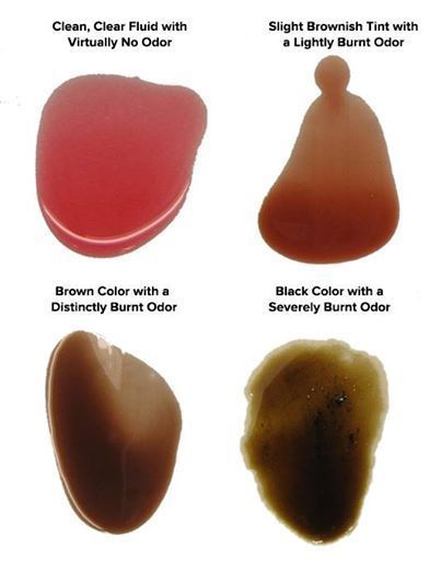

Nice. Just make sure to monitor the transmission fluid.
I change it annually and check it regularly since this is our tow vehicle. I'll be changing the coolant and other fluids as well.
