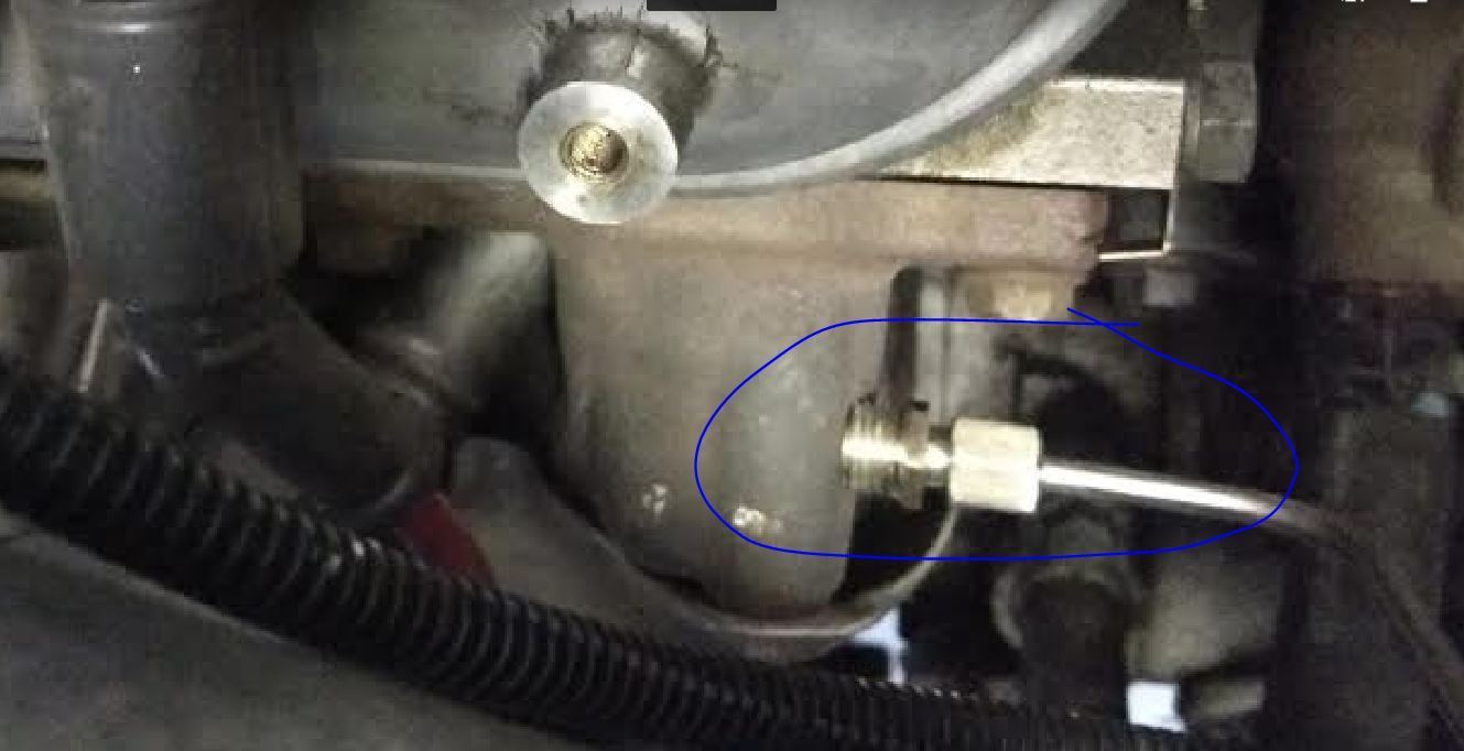

I added an EGT probe on the right side exhaust manifold in the front b/c it was the easiest to get a to tap. With the readings I'm seeing around town and the test pull I did, I don't see above 1000F. But I will be doing a longer trip in the spring and we will see what the reading is when it's hot out and towing hills. But if I never see above 1000F then there's a good chance I'll remove it b/c I don't like the clutter under the hood or inside.
I think the reason why EGT doesn't spike like in a turbo is b/c there's not the impediment of the gasses. When I had this same probe on our turbo diesel excursion it was not hard to hit and sustain 1200F. I'm just not seeing that from the H2 but let's wait till it's 105F outside towing a hill.
