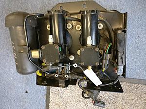

My rear AS unit control module failed but I elected not to go for coil springs as I use the extra 2" ride-height when uncoupling my trailer.
The air-bags should be easy to replace (
) and I bought a complete AS unit 2nd hand for $350 dollars (it actually cost more to ship to the UK)

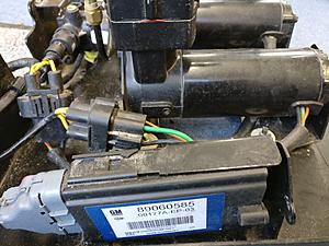

I think you will find the dealer is mistaken, unplugging the AS-Unit cable (under the truck at the rear ) and then disconnecting/reconnecting the battery will cause the BCU to re-configure itself for operation without an AS-Unit. I was forced into doing this after my Control Module failed, this is something you can easily try!

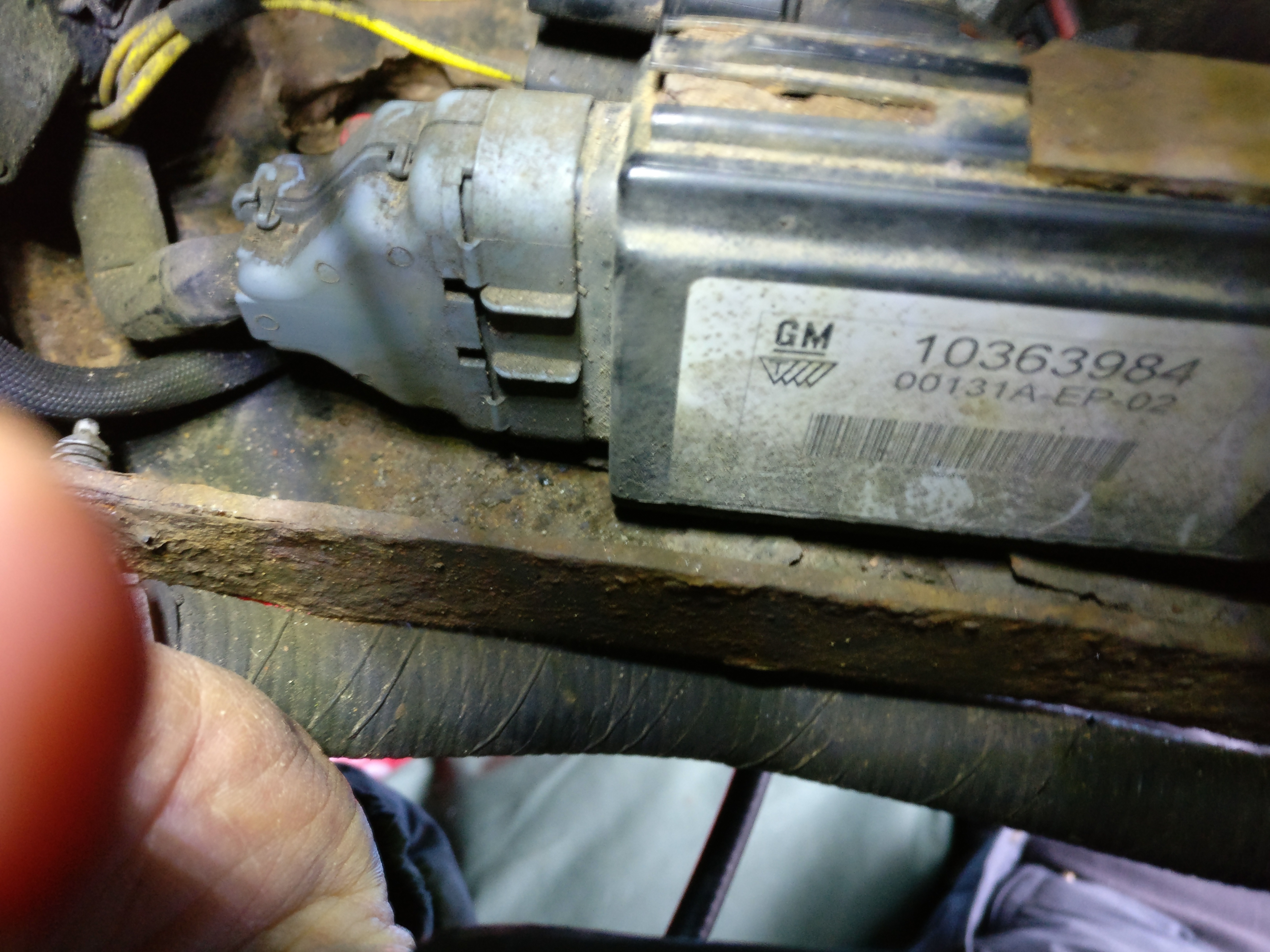

If you elect to fix your AS you will need the GM Part No. located on the Control Module to match your vehicle, watch out for GM's revised part numbers.

When and why would I have to change out the air suspension MODULE you show in the photo? The pump's still run, the only issue I am having at the moment is the red light on the dash will not lock ON and two weeks ago, I sprayed WD-40 and AIR SENSOR CLEANER on the wires of the ride levelers on the sides of each wheel well and strangely enough, that corrected the red light issue, but after two weeks, the light on the dash keeps flashing now and the air springs do not top out.

My AS Module was only replaced because the original failed, yours should be fine.
